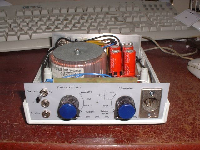

One of the most confusing things is that the switch positions put the 16 or 4 ohm resistor to binding post 3 and 4, and Eric has you put a short between the posts.
Indeed. I found the number of switches quite confusing so condensed them onto two rotary switches. My jig also includes a Gainclone-type power amp and a mic preamp all in one box.
Nice one,
David.

daatkins said:
Good to read your problem is sorted. When Speaker Workshop is up and running, it really is a great piece of software!
Nice one,
David.
