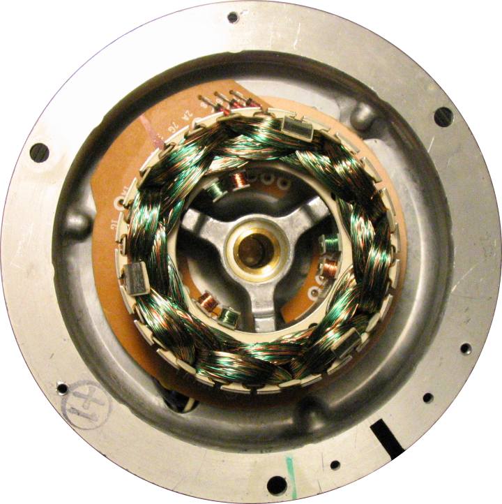

About the working principle: the motor appears to be a 'brushless' three-phase 'DC' unit with a built in tacho generator (Matsushita 'MKL-15SI-T'). This unit is enclosed in a servo regulation, based on an integrated motor controller IC 'AN620' (Matsushita). BTW, can anyone supply information on this one, perhaps a modern substitution (does not have to be pin-compatible, but better 😉)? I've added a picture of the motor internals, you can see three layers of drive windings and three small pairs of tacho 'pickups'.
The problem with it's current control unit: speed sagging under load, bad regulation and too low torque (even the needle slows the platter...).

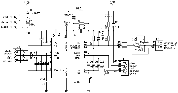

I've grouped the interconnects into four connectors (cable colors matching the original setup):
J1 - power supply, 18V DC (upper left conrner);
J2 - speed selection and pitch setting (on the very right);
J3 - 'S' windings, supposedly the speed meter (left);
J4 - 'A' windings, supposedly the actuator (lower right);
In the center of the drawing sits the AN620, which I know nothing about regarding it's internal structure, as I couldn't find any documentation about it.
The circuitry on the upper right (connected between power supply and pitch regulation input) appears to be some filtering and referencing/biasing.
I haven't measured/read the resistors yet, as they are of no particular importance as long as I don't know what the AN620 does whith what value.
D4 (upper right) *might* be a Zener, but it's not marked or printed on.
D1..D3 are of yet unknown type (long glass body, nothing printed on), but definitely connected this way.
What the RC network R5/R10 and C13/C14 (top, between +18V and pin 16) is for? I can't tell without knowing what pin 16 is for...
There is a wire '?' along the 'S' connections, which has no component print and the actual purpose is not yet obvious.
I've studied the schematics of the Technics SP-10MK2 and the SL-1200/1210MK2 for comparison. It's clear how everything is approached (servo loop with frequency-to-voltage conversion, enclosed PLL with quartz reference and phase comparision, higher-torque motor with appropriate drive), but turning a mediocre controller circuit into a better-than-average is not easy for me...
Does anyone have an idea?
Is it possible to increase the output power (haven't measured the motor yet, but a little more should work easily)?
Is it possible to improve the regulation (haven't replaced the capacitors yet, but they appear to be allright)?
Or is the SL-2000 normally superior to what I describe and mine is broken? 😉
Any comments are appreaciated, thanks for reading! 😎

From what you say it sounds like the motor and controller are not working properly - I would fix the basic problems first and address upgrades after you are sure the motor itself is ok. It is unlikely at this juncture that you will find an improved motor controller IC for this application that is pin for pin compatible, plus I am sure it can do the job well as long as it is undamaged. Far more likely at this time that some or many of the electrolytics are bad and need replacing. Pots and some resistors may be suspect too. The motor itself is not too likely to respond well to higher current drive, the windings were designed to dissipate only so much power. I would focus on making sure that the current circuit is actually working properly. One area where you might make a big improvement is in replacing the power transformer with a slightly larger one, add more capacitance to the supply, perhaps consider voltage regulation to the servo using something like the LT1085, set to 18V to this I would add hex freds or schottky (if piv is high enough) rectifiers and maybe 10000uF 35V nichicon muse electrolytic after the rectifiers.

The behaviour didn't change (worsen) since many years. And the motor seems okay. But I plan on progressing slowly and only where I'm sure what I'm doing. So I plan to use the current circuit as long as I don't have a better solution. I could indeed try to 'repair' the old one and hope for a little improvement until the new controller is finished... 😉
Well, as I wrote, I'm not lookin for a pin compatible replacement IC (I explicitely said so, because I actually don't expect any pin compatible IC to exist).
But a 3-phase 'DC' control is something very basic, there sure are controllers which implement a 'tighter' servo loop (and have a better reference), but are also suitable for said motor...
Yep, I suspect that too (as always with old electrolytics). But the motor can handle higher power, because it's "underpowered" due to the poor power supply at the moment. I'not talking about an order of magnitude or so, just about an (as little as neccessary) higher torque for short durations.
I honestly don't expect the current circuit to be able to perform good enough, even if I could restore it's original performance. It's a really cheap player, due to the cheap power supply and simplified controller. It's one of the cheapest Technics players ever, known for it's mediocre performance... But the motor is capable of more, as it is used in better players, too.
Yep, I agree again, but this is something I'm already planning (as said in the former posts). I actually consider it neccessary, as I wouldn't expect an improvement in performance from the same transformer.
Again, can anyone else recommend an approach to improve or replace the old regulation?

Not really. I have to admit that the conditions were difficult to start with. The platter was excentric, the arm bearings were loose, the power suppy was crappy and the acrylic cover was damaged beyond repair. 🙁
I had stripped the motor assembly from the chassis and experimented with the combination of motor and platter. They could benefit from a hefty laboratory supply (with regulated 18V). My attempt would have been to replace the 33/45 switch and pitch control unit with something more convenient (button switch, single potentiometer) and the stroboscope with LEDs for a sharper image.
But then I got hold of an SL-1710MK2!
There's no way back.
I currently use an SL-1200MK2 that I refurbished and repainted (white chassis, white LED illumination, improved power supply, renewed pitch assembly, recabled tonearm, etc.).
Don't get me wrong, I don't dislike the SL-2000 parts for what they are, it's just impossible to improve them beyond what they are capable of - at least not without spending more than for a used MK2.
Sebastian.
PS: I like to keep the SL-2000 parts in the drawer, though. We share the same year of birth. 🙂 So in case you have any questions, don't hesitate.

Sek, your shematic shows no frequency reference (quartz crystal) so it will not be as accurate as designs like the SP10. (probably because they want pitch control, and pitch control with PLL is (was) not an easy or cheap circuit)
The motor also appears to have no true tacho coil - only the three phase detection windings. These CAN be used for tacho purposes as well, but are not very accurate (from the SP10 motor measuremnts I did, only about 6 pulses per revolution, as compared to 190 for the true tacho pickup). For PLL control you will need that sort of accuracy (190 pulses per rev). You could always add a photo-detector on the rim of the motor, and stick on a laser printed band of stripes for it to read.
To answer some of your questions, I'm guessing the following:
D1-D3 are germanium signal diodes, to demodulate the AM signal from the phase detector.
The white wire at S2 is likely the excitation voltage for the phase detection coils - probably at around 50kHz.
R10/R5 etc. MAY be the lead/lag compensation for the servo loop.
I imagine you could certainly increase the current drive to the motor. - after all, it' only the impulse current to get it up to speed, its normal runing current will be unchanged. It has a long thermal time constant and won't suffer badly from a higher start current.
Hi Steerpike,
I'm not the one who wants to improve it (anymore). 😉
I'm aware of the things you mention since I dissected a SL-1710MK2 and a couple of SL-1200/1210MK2 for comparison. The SL-2000 incorporates the technology that has also been used in the SL-1200 series (without MK2): no frequency generator, no crystal reference.
Oh, and I recognized your thread and followed it from the beginning. 😉
In other forums, I discussed the option of retrofitting the motor assembly with a frequency generator coil (i.e. from a superseded MK2 series player or a DIY one) and a reference generator circuit. But the amount of work is similar to your approach of a redesign...
Thanks for your description.
It's even more severe: I made a mishap in my circuit description and accidentally took the drive coil connections for the position detector connections and vice versa. It's the other way 'round. 🙄
The circuit can be improved as you mention - by increasing drive current and adjusting the lead/lag network in the feedback loop to the servo. Measured frequency is lower than 50kHz, btw...
But as the controller IC is not documented anywhere, the risk of increasing the current through the IC is too high for me. At least, it incorporates a metal plate for mounting a heat sink. External driver transistors are a possible solution, but too complicated to fit into the original housing...
Sebastian.

D1-D3 are germanium signal diodes, to demodulate the AM signal from the phase detector. The white wire at S2 is likely the excitation voltage for the phase detection coils - probably at around 50kHz. R10/R5 etc. MAY be the lead/lag compensation for the servo loop.
Sebastian.
