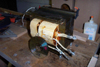

I plan on building a 4 channel...I know, I know..a heat monster. I am going to use the Iron transformer in pic. An easy 3kva item. it has primaries that allow a few voltages including 20+20. Tranny will be shielded in copper in the chassis.(I have an uncle that specializes in copper roofing!) I'm prob gonna locate some 53a Ixys bridges.
A lot of guys prob won't like this idea...but...I have 4 - 7"x15" heatsinks that I'm considering arrainging in a 'wind tunnel' configuration. I have some 24 volt 6" brushless fans that are super quiet at 7-10v or so, and don't seem to need a kickstart.

I certainly have no problem with anybody using a fan. Your heatsinks will probably be cooler than mine. One question for you though. Are you going to run your amp at 220 VAC input? With 4 channels you will be close to exceeding 15 amps draw from your ac line at 120 VAC. You will also have to think about the enormous current that will be required at power up. Other than that, I always think bigger is better😀
Yes, well..120v would be used. Do you really think I will be looking at 15a continuous? I am aware I will be looking at solid continuous draw..but...I didn't realize it that high. Maybe I should have pulled out my calculator for a moment. ......
Kilowatski..thanks for pointing that out
With 20 vac secondaries and a simple capacitive filter of 100000uF you should have about 26 volt rails. you will be dissipating 1248 watts of heat alone. Get the Aleph X AXE-1 speadsheet and it will do the calculation for you. If the cumulative thermal resistance of your heatsinks were 0.1w/degrees C (which is terrific by the way) the temperature of the sinks would be 291 degrees F. I think you should also look into heavy duty water cooling because your power transistors would self destruct in a few minutes. Seriously, if you still decide to do 4 channels I suggest 4 separate chassis so the heat can be managed a whole lot easier.
