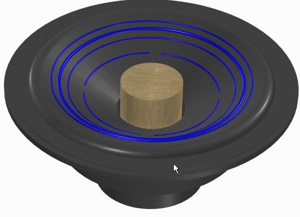

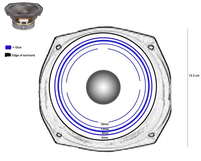

I can't wait til you're done with the project. So far, the FR looks great. I want to do this to, but a bit confused with step 2.
Can anybody do a quick illustration to what Mark is talking about? I would really appreciate it.
Thats great value for money stuff!
How does one know exactly where and what modifications to apply! Bell modes,axial modes wrecking the FR yes?
Cheers!
Cheers!
Have you measured the effect (if any) of putting some kind of putty on the stamped frame to kill resonances?
bzdang said:Like this I think (it's late here)
thomas997 said:damn bzdang had to go and outdo me while I was drawing it up!
oh well another sketch wont hurt 🙂
you guys are awesome
I have a question though, would the glue last for at least awhile?
It seems that the rings of glue are essential in this mod.

I have not looked at the two illustrations provided, but I have posted photos and illustrations in my MarkMck's Tang Band thread on on my own Web site of other modification projects.
I will include one of my illustrations and a photo on my Web site when I get the page/project up and running.
My thanks to the two people who did post illustrations.

The carbon fiber cone does not behave in the same way as the polypropylene and requires a material with differing characteristics to achieve the same results. You can control the vibration modes in polypropylene with low temp hot melt, but it requires a precision of application (particularly bead diameter), that is difficult to achieve and replicate. Because the carbon fiber cone is different, the variable bead diameter is not a problem and the higher density and rigidity of the low temp hot melt is beneficial.
As I have stated before, I am posting glue mods because they are easily duplicated. It requires no special skills to complete the modifications.
I really do not want to discuss other's marketing. As you state, it has been discussed already and I chose not to say anything to those threads.
I have not tested the drivers mentioned and so I do not want to comment on what problems they may have and how effective specific attempts to correct those problems may be. I will, however, say that this edge treatment (bend at extreme outside edge) is not specific to metal cones. As you describe it, the carbon fiber cone has a very similar shape.
Based upon nothing but my understanding of this shape in carbon fiber and my work with other metal cones, the corrections you describe are in the wrong location
I will say, however, that much of what is being done to correct cone vibration modes is only marginally effective (if at all). For example, applying coatings to entire surface of domes and cones (metal, poly, or paper), while it changes the response, does almost nothing for specific vibrational modes.
Lastly, I know people want things to be simple, but just because a theory sounds logical does not mean that it has anything to do with the actual performance of drivers. For example, yes, a non magnetic, conductive metal ring or plug placed in front of the gap will reduce the inductance of the voice coil. The reduction, however, is minor compared to the total inductance of the voice coil. In use, any impact, for distortion or high frequency extension, is swamped by other variables. I can measure the small drop in inductance, I cannot detect changes in performance. And I even doubt the logic of reducing inductance in front of the gap as beneficial.
In sum, I am making changes that can be documented and easily heard as an improvement. I do not wish to stop others from investigating the variable of their choice, but for me it is not.
Again, thanks for your interest,
Mark
