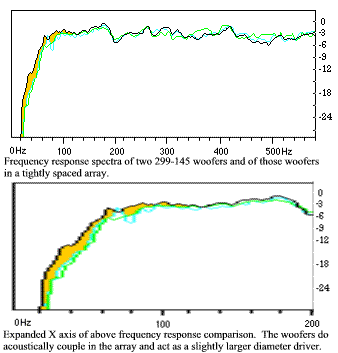

Small diameter drivers appear to have a problem with low frequency acoustic reproduction independent of T/S characteristics. When Fs is low in frequency, the acoustic output begins to fall off at frequencies higher than predicted. A logical question sourced from this observation is whether multiple drivers closely spaced will acoustically couple and act as if they were a single driver larger in diameter.
By the experiment I devised and conducted, it appears the answer is yes. When closely spaced, small diameter drivers can be made to act as if they were larger in diameter and come closer to the low frequency acoustic reproduction predicted by T/S analysis.
It has not been easy to control for variables in the test execution. Without control of the variables other than acoustical coupling of drivers, experimental conclusions would be suspect. Still, with the construction of specialized test jigs and careful implementation, I believe that the results I post here accurately reflect the performance difference due to acoustical coupling of the two closely spaced drivers.
There is a measured increase in low frequency output such that the combined response comes closer to T/S derived expectations for this driver. In the case of this 5.25 inch advertised diameter driver with Fs in the mid 60s, its performance was already close and simply coupling two drivers achieves maximum response. Adding more drivers to the closely spaced array is unlikely to provide additional performance improvements.
Like all design, there are both positives and negatives to the technique of acoustically coupling multiple drivers. There are indications in these tests of both additional benefits and liabilities caused by using even two drivers in an array. Positively, there is smoothing of individual differences in driver performance. Negatively, there is evidence of accentuation of problems shared by both drivers, even at relatively low frequencies. This is particularly evident in the response just under 200 Hz where the bump and then dip in response is greater than either driver alone. With just two drivers, none of the negative consequences are critical. Whether that will hold true when using more than two drivers in an array will require further testing.

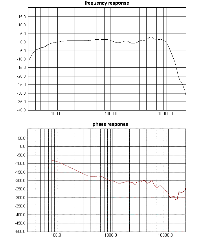

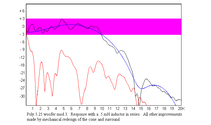

Just a quick update on the continuing work on this driver. Now, the the glue ring and glue line modification remains valid. This new work, even when completed, will not obsolete the glue ring/line design.
I wanted to look at two things in this new design. One was the influence of the surround and the second was eliminating the parallel notch filter. I want the driver to not need any equalization.
I am getting close, but am not quite there yet. Most of the hump the notch filter was equalizing has been controlled through cone modification. Not a complete success yet because a little peak at 5 kHz remains and the driver still has a slightly rising response. The rising frequency response can be equalized with a .5 mH inductor. This inductor does reduce high frequency extension slightly, but still allows for a bandwidth to 10 kHz.
The driver rolls off at 6th order acoustic rate. It is generally smooth and does not require additional filtering.
A three frequency response graph of the new design is posted below.
Good designing and good building,
Mark
Just for fun I thought I would try to present the performance of the new modification by the testing standards of other people. For this posting I used a company generally well thought of as my reference.
I have included frequency response and phase response of the 5.25 mod 3. There is no smoothing of the frequency response. The loss of detail from my typical postings is all done by setting boundaries on the data set for the FFT. No limits were, however, used for the phase response. Vertical resolution (both for magnitude and for phase angle) is identical to that used by this other company.
This other company does not make a 5.25 inch driver. They do make a four-inch driver. While their four-inch driver has an extra octave on the top end, the 5.25 inch driver has an extra octave on the bottom end.
The retail price of the 5.25 inch driver is 12 USD. The other driver costs about 12 times as much. I am certain that that driver is much better than the modified 5.25 driver, but using these testing standards it is not easy to tell that it is.
Mark
Mark

Mark,
All this recent discussion reminds me of a question or two I've had for while.
I am building line arrays with the 299-145 drivers and intend to cross over at 2000 to 2500 Hz to pair of DIY line source ribbons. I will cross over temporarily on the bottom to a pair of elderly Tympany 1D's. The purpose of the whole effort is to provide a test bed to experiment with the ribbon tweeters.
O.K. On your web site you present graphs of the unmodified 299-145 and final graphs of the driver with all the mods. I found myself wishing that you had run a graph for each mod as it added. In particular I am curious to know what the gaphs look like for the driver with the pahase plug mod and the glue ring mod but without the equalizer.
I am doing the physical mods and will be building a low level 4th order LR xover to operate in the 2000 to 2500Hz range. If your equalizer is used to mitigate a 5000Hz peak then it looks like I might be pushing things and may have to add a notch filter. Any advice?
Thanks in advance.
Graeme
P.S. MB - I bought a couple of those copper plumbing caps. They work very nicely indeed. Thank you for the great idea.
Thanks in advance.
Graeme
