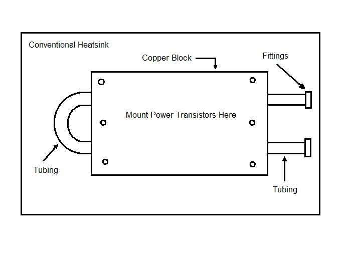

Why not get a pair of conventional heatsinks and two 6" by 6" copper blocks. Drill two holes lenghtwise in the copper block about 4 inches apart. The hole size should be slightly larger than the diameter of copper tubing youn plan to use. Take a length and make a 4" loop. Solder the loop to one end of the copper block and two straight tubes to the other end. Solder a couple of fittings to the other end of the straight tubes. Put some thermal goo on the copper block and bolt it to your heatsink. Mount the block to your heatsink. Mount your transistors to the copper block. If I am correct the block will act as a heat spreader for the conventional heatsink and also as a watercooled heatsink itself. Because of the combination of the two heatsinks the copper water cooler you just built would not have to work as hard and one of those new passive radiators for computer water cooling could be used. It's noiseless, efficient and easy to implement. See diagram below.

Although putting a serpentine copper pipe along the back of a copper plate would work wonders, I've yet to outstrip the heat-carrying capability of ordinary 1/2" copper pipe soldered to the thin edge of a 1" x 1/4" copper bar, thus: --O The devices mount to the wide side of the copper bar. Cheap, easy, efficient, and if you polish the copper nicely it looks pretty sexy.
I'm not saying that all these high fiddle-factor ideas won't work--it's just that you can get excellent results with a whole lot less effort. Water cooled systems are so effective it'll scare you.

"A proper bending tool would need to be made and used to keep the tube from collapsing when being bent."
That can easily be accomplished by filling the copper tubing with low melting point Bismuth metals of the type used in sprinkler heads. After you've filled the tubing with the special metal and made the bend just heat up the tubing to recover the metal and use it to full the next pipe then bend and so on down the line. This way no bender is needed, just a simple jig to keep them all the same. I used this method once when I built a scale model steam locomotive and it works beautifully!! The low melting point metals are available from Small Parts Inc in Miami.
I am still contemplating doing what Kilowattski mentioned except I am not planning on soldering tubing into my copper plate. I will just drill and tap the holes for small copper fittings that will be silver soldered to make them leak tight. This way simple flexible tubing can be used to join the cooling system together. Ia lso feelt hat with water being in direct contact with the copper plate will increase the efficiency quite a bit.
