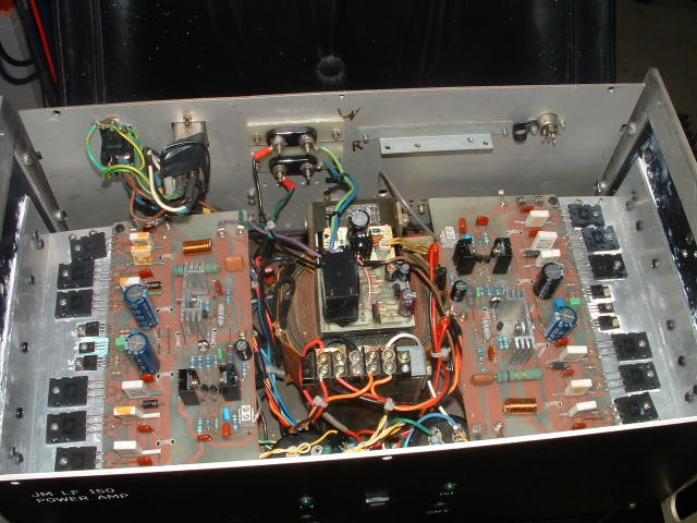

ok, well i have just finished building two of these suckers..
I managed to build them both into a 3U rack case too
so far i have only tested it out with 4R subwoofers and the only sub that could handle even half teh power was a phenix gold 1000W 15". anyway, that doesnt say much..

I have just finished to build one, with only half of the power transistors. And i made some tortures to this great amplifier. I plug it to my electrostatic loudspeaker prototype, about 0.5 ohms of impedance... I have plenty of power and audio spectre is excellent maybe a little too brite. But this can be corrected with a simple equaliser circuit.
What amazed me is the high PSRR when there is no signal input there is absolutly no hiss or hum hearable even the ear stuck to the speaker.
And i have just 5400uF on each side of the dual supply polarities.
There is still some errors in the construction details, like the output self
6.8uH. In the text they says use a 3 meters long 1mm diameter copper wire... In reality it's 1 meter long. You have to use 0.5 inch diameter inside core make about 6 turns each layer (that make about 0.25 inch of thickness) and you repeat for about 3 layers, +- 21 turns. It's difficult to layers rigid wire like that it tends to spread between previous layers, so i put a tape on top of each layer. Voila!
Here is a photo of my prototype:

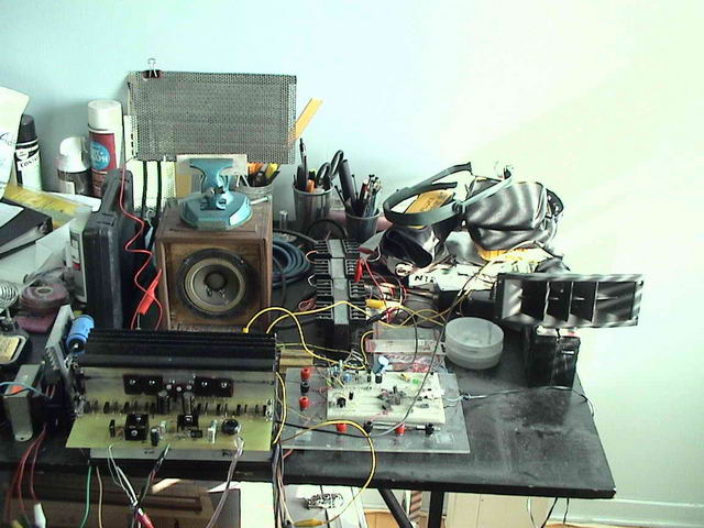

A photo of my loudspeaker protype.

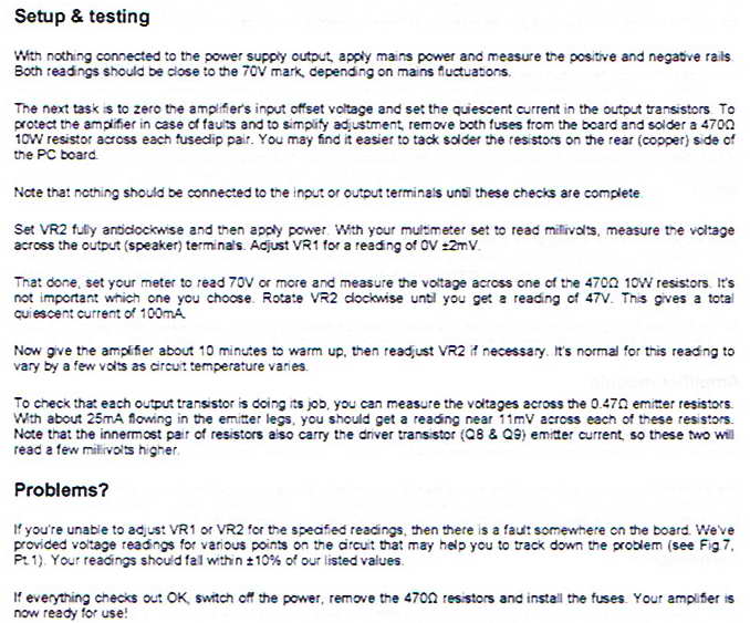

Jaycar/Silicon chip Studio 350 testing instruction
Hi there i'm newbie
You, Mandrake5 or some one, Can please post the complete
testing instruction of Studio 350
like "bise" adjustment and also the adjustment of "VR1" as stated
by SC.
I have no access to them
:att'n:
To TOHEED Setup and Testing.
Hi TOHEED i search in my papers and i found what you wanted, the
setup and testing procedures.
I scan my paper so forgive me the low resolution but it's readable.
Hope you found this usefull and you have succes in building that high performance amplifier. If you have further questions dont hesitate to contact me.
So here it is as a picture.
Bye
Mandrake5🙂
