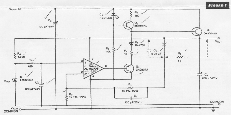

Improved LM317 ?
Searching the archives I came up with this "better than datasheet" implementation of the LM317 regulator according to some...
I think the idea is to fixate and isolate Adj from noise of the output, so the LM317 only regulates to keep 1.25V difference between Vout and Adj ?
Or do you effectively break the feedback loop, making the regutor "worse" and have the output caps do all the AC work, but sonically better due to removing regulator induced sonics ?
I'm puzzled.
Same questions with TL431 shunt regulator and capacitor decoupled reference...

improved 317
Rudolf,
Since the 317 does its best to keep 1.25V between Adj and output, the quietness of the Adj has a direct effect on the final result.
In the diagram you posted, Adj is made as stable and quiet as possible by using a current source and a ref diode. That is at any rate better than just the customary resistive divider with decoupling cap. The 'resistive divider' formed by I1 and D1 - for noise etc - probably is something on the order of 1 million to one, which will be hard with an R and C, especially at low freqs.
The other question on the 'musicality', whatever that is, is another matter altogether. The 317 is there to approach an ideal volt source. After all, the amp is designed with the assumption that it is fed with a DC voltage. If you think a less ideal volt source makes the amp sound better, there is no overriding reason to use a 317 or whatever regulator you can think of.
Cheers, Jan Didden

Hi yourself,
There is one additional change I did in one of my implementations which as far as I know hasn't been documented, and that is replacing the current source on the input side (you know, the LED & transistors and couple of Rs) with a current reg diode (CRD), which actually is a FET connected as a current source. IIRC I used a J50x, try to find the highest value, like 10mA. This does further improve input noise and ripple rejection especially in the higher freq area. There is one caveat though: you need at least 7 or 8V difference between the input and output to have the CRD function correctly. But other than that, I find it worthwhile towards measurable better performance. Whether it's worth it sonically is something I cannot decide for you for obvious reasons.
Cheers, Jan Didden

Jan, can I pick your brains a sec?
Just a couple of brief questions that have arisen from the succesful implementation of the EDN super-regs I've just built, hope you can shed a little light.
1. I'm very puzzled as to why the sense line decoupling capacitor was taken to the regulator o/p. Even with this implemented I've had low-level oscillation at HF with the remote sensing option.
Returning the decoupling capacitor to 0V though cures it completely under all conditions I've tried it in. I'm curious because the connection seems unusual and less effective than it could be, although there must have been good reason for it.
2. Did the sense plane over the board just connect to one single point (i.e. the -ve sense resistor point) with the LM329 and it's filter capacitor returned to this point via tracks, or were the LM329 and filter cap returned directly to the ground / sense plane?
I have the option for both, but need to do a bit of work to increase resolution of the T&M system in order to assess, and was hoping for a pointer based on your experience.
I'm though stunned by the sonic performance - a simple PSU, containing a single +ve regulator (@ 24V) outperforms a major name HiFi manufacturers very expensive PSU, containing seperate regulators for each channel, by a considerable margin (and costing some 800 ukp!).
The vanishingly low o/p impedance of the super-reg's allows just a single unit to be used, providing star-connection schemes are used, although I'm sure there will be benefits to seperate reg's.
Thanks for your part in this - must drop Walt an email too, assuming he's still contactable.
Andy.
