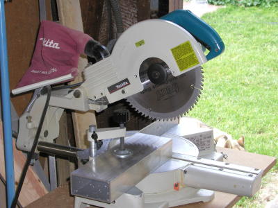

Band saw is for cutting metal sheets?
While I like to use band saw for sheet metal, anything over 1/4" is pretty hard to cut. In that case I'm using 10" compound mitre saw with non-ferrous metals blade. For me that's the best way to cut anything up to 8" wide and 4" thick. I even cut large heat sinks in that manner. Your piece must be properly clamped though.
