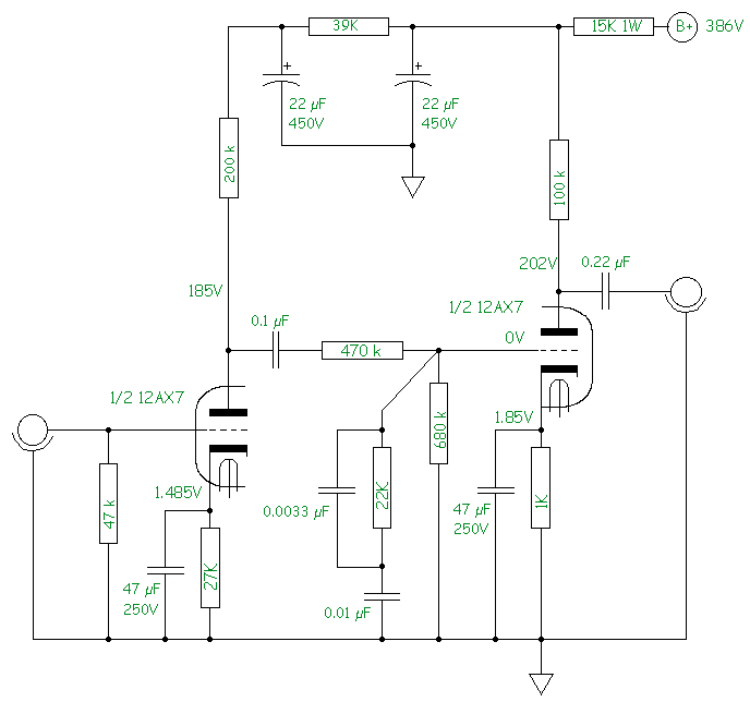

I have built the RCA phono circuit several times with good success. There is a good write up on it on the JE Labs website. On that site Joseph recommends 6SL7s, but I found them to be too microphonic to work with. I've had better success with 12AX7's. One of the things I like about this phono stage is that the RIAA equilization is between two stages and is not in a feedback loop. Other DIY phono stages I've tried are the Curcio replacement for the PAS phono stage, okay, but sounds a bit congested to me; and the phono stage from the Audio Note M7. This is a nice little circuit and easy to build. Overall I think the RCA version is more musical. But YMMV.
Now I will add that I've recently been thinking of taking another run at a phono stage myself. And that is likely going to be the Marantz 7C (you can see it on the Fi Primer site) or a clone of the Fisher X-100 series style. I've heard the Fisher and really liked the sound. The only trouble with using clones of these old stages is that you have to "backwards engineer" it from a schematic that generally includes pretty intricate input selector switch configurations. Once you can trace it out, however, it should be pretty easy.
By the way, layout of this stuff is much more important than a line stage. I'd highly suggest you get a look into the bottom of something like a Fisher integrated and see how they layout the parts and grounding scheme. It is pretty important stuff. This also means you can borrow what others have learned in terms of layout, rather than be disappointed after stuffing in a bunch of expensive parts.

Look for post #10 in the thread "dc phono", similar topology to the RCA circuit with 2nd stage using 6DJ8/ECC88 which has lower plate impedance for better output drive and grid leak bias for better LF response, also has 2nd stage input coupling capacitor after the RIAA eq network for DC on the eq caps which may improve sonic character. I want to build the "dc phono" myself but need to find time to do it.
I built the RCA circuit in the early 80's and the high output impedance didn't work well with my SS line stage at that time, if I were to try it again I would use 6072/12AY7 instead of 12AX7, lower gain but also lower noise, lower plate impedance, and less competition for quality NOS tubes, but the values of plate resistors and the 470k eq network resistor would have to be changed.

Kofi Annan said:It looks fairly simple
Twice as many sections as the RCA one i posted (i haven't heard this one). If i was building a single-ended phono i'd probablt tackle this one:
from Vacuum State web site.
You'd only need the 1st stage, but depending on what follows & how close you might need the follower stage. Some schema from earlier versions there too.

And make sure it has a very well filtered low noise PSU.You'd only need the 1st stage,
Make sure the following stage has an input Z=50k or the RIAA won't be accurate.but depending on what follows & how close you might need the follower stage. Some schema from earlier versions there too.
OK, because I'm pretty green, can you recommend a regulated / well-filtered PSU for this (schematics would be much appreciated)?
Does the phono stage end at the grounded 1m resisitor and, if so, does that become the lead out?

At the grounded 1M resistor, right before the selector switch.
What follows after that however is of the utmost importance to maintain accuracy of the RIAA correction curve as is stated on a note in the pic regarding the 50K pot.
Combining this phono stage with the Foreplay preamp would require it to have an input impedance of 50K (pot or constant impedance attenuator can do).
Brett already mentioned this in the previous post.
No idea what the Foreplay has for values there so check the manual for this info.
If it were to me building the preamp I'd build it as shown and put the Foreplay aside for the time being.
IMO the best way to proceed would be to order a Superreg (maybe two are needed?) for this pre as I don't think this part was released to the public.

Can I use a B+ of 200V on the RCA phono circuit? If not, can I change any of the resistors to so that I can use it for the 200V B+ I have?
