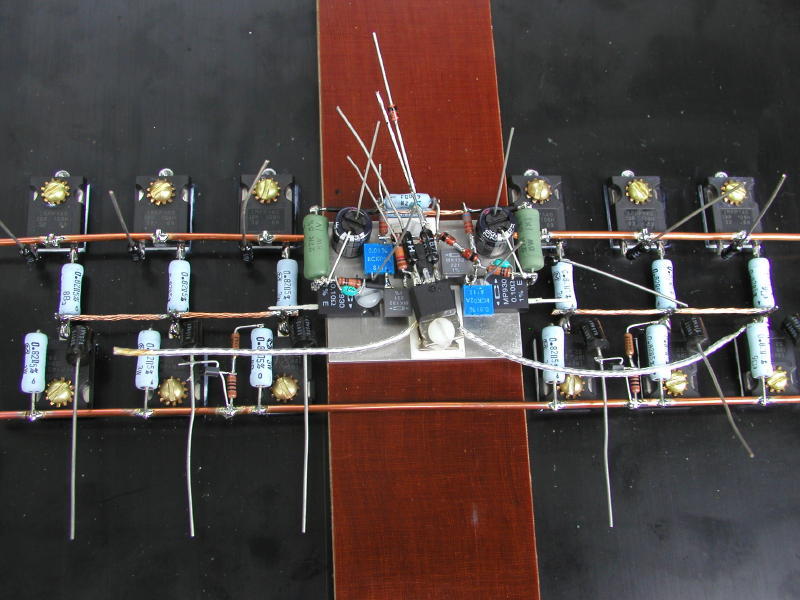

Anybody still arguing that making PCBs is better? I don't see a better way to built this circuit. Of course it's still work in progress but the end is near. Any idea what this might be?

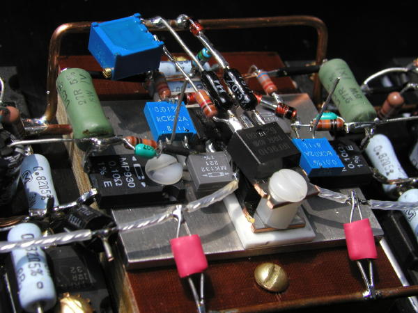

That's the close up of front end. I mounted differential mosfets on metal plate and current source mosfet is suspended above. Two green power resistors are the outputs to ground 30 ohm. You can also notice that I used 0.1ohm Caddock resistor at the output. It's 16W and it compact size really fits my setup. I also thin it souns much better than the bunch of parallel resistors. Everything could be so close together that signal traces are practically not existant. I'm really curious about the sound, but still second channel and PS have to be done.

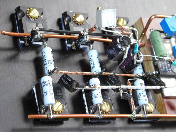

And the final picture shows how the output mosfets are connected. You really don't need the PCB for that stage, everything fits together and locks in place. By using PCB I would introduce unnecessary connections and longer signal paths. You can see the sensing circuits hanging between the rails. I had pretty hard time puting current sense circuit together but finally I manage to make it compact. That's the place for those circuits, beside output devices and not on the front end board. Grey, you can see that I'm also using Panasonic blue power resistors. With so many of them in the output I would be hard pressed to spend money on anything more expensive. And thank you for the Aleph X circuit.🙂

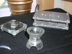

No, those screws require the threaded hole. You can drill straight holes on table drill or you can use the drill guiding blocks like I'm using. Two of them are commercial pieces, used in aircraft industry, the third one is home made. I also use them for tapping the holes. As I said before cordless drill gun with a clutch works the best here.🙂
