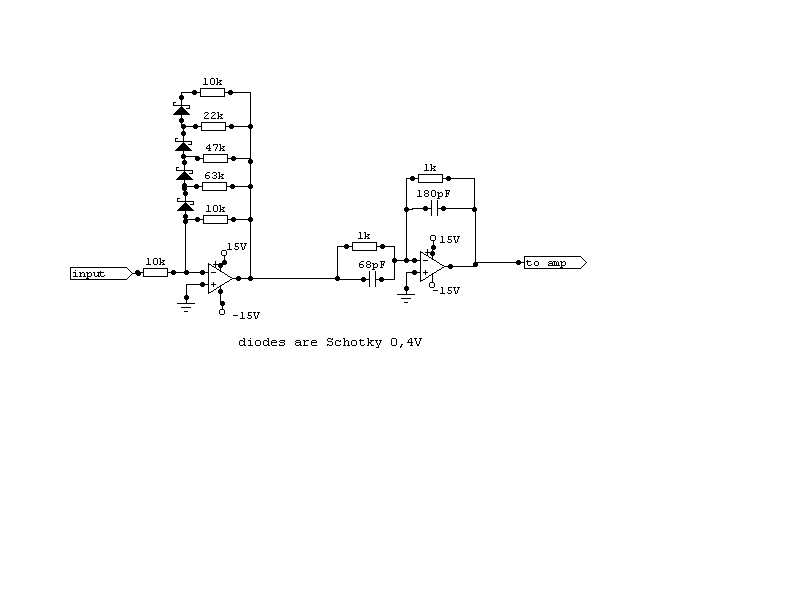

Nowadays the power amplifiers are getting better and better
the parameters indicate that they are nearly perfect.
Nethertheless many people prefer the old-stylish
single-tube class A amplifiers and they claim these amps
sound softer, vinage and natural. Why is it so ???
Personally I think it is a question of non-linear
distotins. A semiconductor distotrs the signal symetricly
which makes the sound 'odd-harmonical','severe', metalic and
overal ugly.
On the other hand a single tube distorts much more but
not symetricly and the distortion pruducts include even
harmonics which are welcome becouse they sound as if the
musical instrument made more its natural distortions.
What is more, some audio maniacs feel the absolutely
non-distortive MOSFET amps are just 'dull'.
So maybe religiously avoiding any distortions is a false path.
In fact every speaker and every human's ear distorts.
Even the air pressure changes aren't linear- they're adiabatic and it brings distortion too.
Instead of this, how about introducing some not symetric
distortions??
As your power amp starts to distrort at the signal level of
2V or 1.8V or close to these values try putting
such a circuit(attached)in front of it.
I think it would be nice in the guitar power amp too.
What do you think of this simple solution???

a Good read:
http://ken-gilbert.com/images/pdf/tvt.pdf
I think it is a common misconception that tubes sound good or warm BECAUSE of the HIGH even order (especially) 2nd harmonics. They sound good because the are LOW in 3rd harmonic distortions.
For some reason tubes are known to have high distortion. This is simply so because engineers decided on THD distortion as a benchmark. This benchmark is irrelevant for humans, and in fact you could say that for a human (engineers are not in this category ;-)) tubes have LOWER distortion than any other active device known to HUMANS
Sorry I did not answer all your other questions.

Very interesting. I'm not an expert, but this differs from those articles. They stressed on high 2nd harmonic, not low 3rd harmonic.I think it is a common misconception that tubes sound good or warm BECAUSE of the HIGH even order (especially) 2nd harmonics. They sound good because the are LOW in 3rd harmonic distortions.
This is what I read in Self book. Amp should be as clean as possible. If you want added harmonic, put a buffer/preamp with rich harmonic and "niceness" switch button on the amp panel.somebody, who don't know to made amp with low distortion, will be every time claim, that distortion give " human proportions " to the listening of music
But howcome his "Blameless" power amp is not so popular? Anyone has built DougSelf's "Blameless" power amp? How does it sound?

How about the simplicity factor. Tube amps usually built on very short signal path with low number of component in the path. SS tends to have longer transistor chain in its path.
It is because, that many demagogs all around the world have stronger voice and really a few people heard sometimes amp with really good parametres. Why do you think, that Wilson Audio show his boxes on Halcro amps ?
Upupa Epops said:But howcome his "Blameless" power amp is not so popular?
Actually, his 'Blameless' amp. isn't that blameless afterall....
lousy SOA protection, which activates, even when output stage is not in danger.....
poor recovery from clip.....etc...
