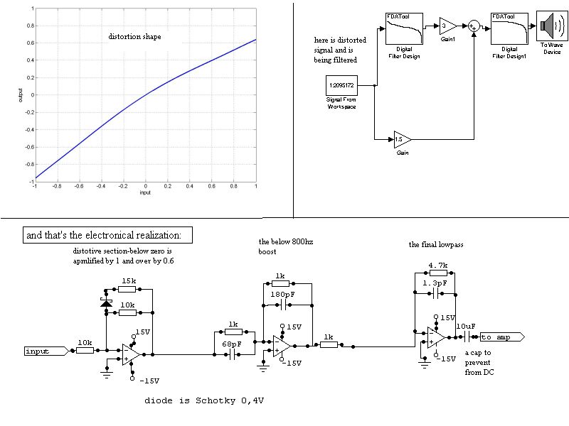

darkfenriz said:
hey men
did anybody look at my damned schematic???
or do you feel you are actually answering the topic I've raised??
or has it gone astray???
maybe some of you did a similar preamp circuit introducing distortions???

Since I feel I've met some scepticism and misunderstaning when I raised
the topic of distortion, I suggest a little DSP
simulation(look into atachment). If you are a happy owner or are
able to reach MATLAB workspace please make the simulation
(you can do it as an m-file) as follows
(it works on the 'c:/1.wav' file and plays
the original and then the enhanced wave):

thanks for the hint!
I simulated your circuit in a circuit simulating software and the distortions look fine :) I mean there's mainly even order harmonics, mostly 2nd.
Would be nice to simplify the circuit. And it would be great in my opinion if one could build an easy circuit where you could regulate easily the character of the distortion, to vary between even and odd order, and high and low order harmonics...
Cheers!
