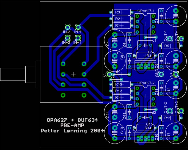

I think the layout is fair but somehow I don't like your efforts to create a groundplane. Probably it will work fine but I would still suggest that you have ground under the opamps and two traces with v+ and V-, close to the IC's. I would also suggest compactness and smaller parts if possible.
Maybe you should have the BUF's close to the outputs of the opamps? Try to get the physical layout similar to the schematics.
Why don't you consider a pcb with groundplane? If you are going to make it yourself it's real easy with a groundplane. Just put brown parcel tape on the upper side. Se picture below.

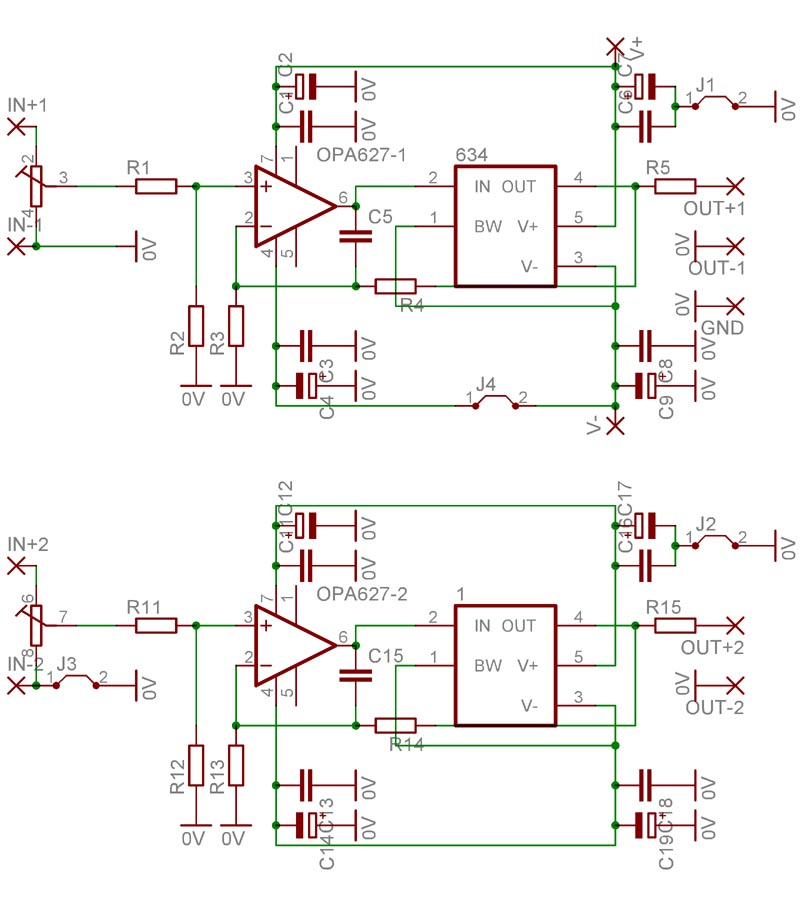

Are you sure you need R5 & R15? It negates the effect of the buffer. What's the value of those resistors?

peranders said:....Why don't you consider a pcb with groundplane? If you are going to make it yourself it's real easy with a groundplane. Just put brown parcel tape on the upper side. Se picture below.
Now that's an easy way to get a ground plane! 🙂
Maybe I'll do that, and have all ground on top layer.
Jan Didden
50R
tape
etch
drill a bit with 3-4 mm drill
very easy
A OPA627 can't drive a 50 ohms cable at high levels but is this the case?janneman said:
Jan Didden
P-A,
What do you mean by '50 ohms cable'? Surely you don't mean a cable with 50 ohms between the two conductors? Any decent opamp can drive a 50 ohms *characteristic impedance* cable, of course. It all depends on your termination resistor. If this circuit is used to drive a power amp of a couple of K or more input impedance, the buffer is pretty useless. If you want to drive say 30 ohms headphones, the buffer is a good idea, but then you wast more than half your power in R5,15. That's why I asked. It all depends om the application.

I'm going to use this as a preamp for power-amps, not as a headphone amp. Should I leave R5,R15 out?
No that's OK for this application.
I did note that you used the wide band connection for the buffer. That is important not because you need the bandwidth, but it puts the buffer in class A for this application. That may in fact be the advantage of having the buffer here. But for driving the power amp & cable (unless it's a lot, with high capacitance) you wouldn't really need it.
