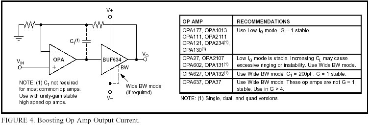

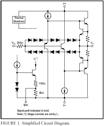

Christer,
Thsi is what the data sheet says:
"Most general-purpose or precision op amps remain unitygain
stable with the BUF634 connected inside the feedback
loop as shown. Large capacitive loads may require the
BUF634 to be connected for wide bandwidth for stable
operation. High speed or fast-settling op amps generally
require the wide bandwidth mode to remain stable and to
assure good dynamic performance."
The idea is that the buffer is so much faster than the opamp that it does not contribute phase shift, but does buffer th opamp from cap loads, so no series resistor is needed. What IS needed is an input series R of 50-200 ohms for stability. Was that in the circuit? Don't remember. Your turn to check that.
Edit: Don't bother. Neither Alcaid's nor P-A's schematic show the series input R. They must love to live dangerously...
So the circuit looks like PMA's? At the bottom the schematic says "P-A Sjostrom". Funny...
Jan Didden

Well, as I said, I was referring to Jungs recommendation
regarding discrete diamond buffers, and he recommends a
series resistor at the output. I wasn't sure what the BUF634
datasheet had to say, but I checked it now, and I think you
missed this sentence: "Response with some loads (especially
capacitive) can be improved with a resistor of 10 Ohm to
150 Ohm in series with the output."

Don't see a series resistor on the buffer input in this schematic:
It is only mentioned in the text. Neither the inpur resistor
nor the output one appears in any figures, only in the text.

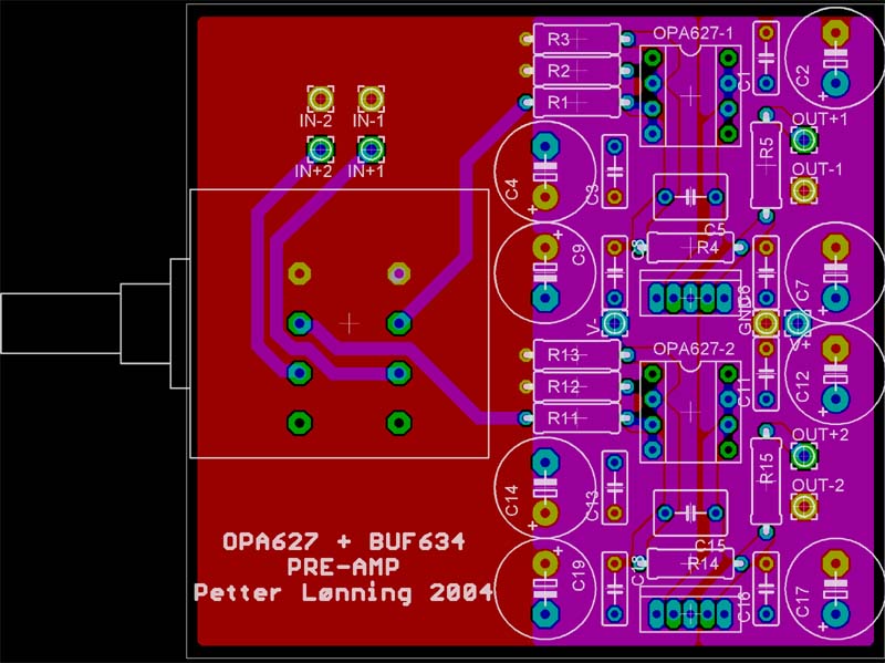

Alcaid said:Some updates:
Groundplane like peranders showed.
Polygons for V+ and V- on signal side of PCB.
Any comments on this?
Turn the noble 90 degrees and leave space at the back:
you (or anyone using the pcb) can use a motorized one then.
Greetings,
Greetings,
That's a good idea, but I don't intend to use a motorized pot. The way it is set up now, it fits my needs perfectly. I'll put the preamp pcb at the back in my cabinet and extend the shaft of the pot to the front. Voila! Short interconnections between the PCB, the RCAs and the source selector.
Christer said:Alcaid,
I just saw another thing. you may wish to add capacitors in
parallel w. R2 and R12 to filter out RFi at the inputs.
Thanks for the tip. What value would you suggest? Don't think I will implement it though because of space constraints.
