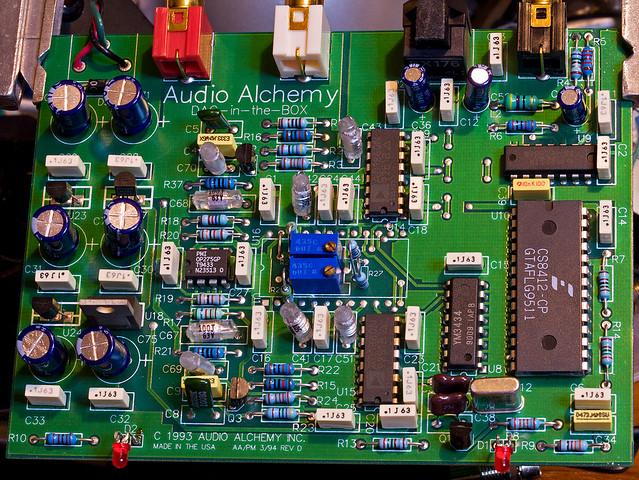

  • Audio Alchemy DAC in the BOX-schematic.pdf

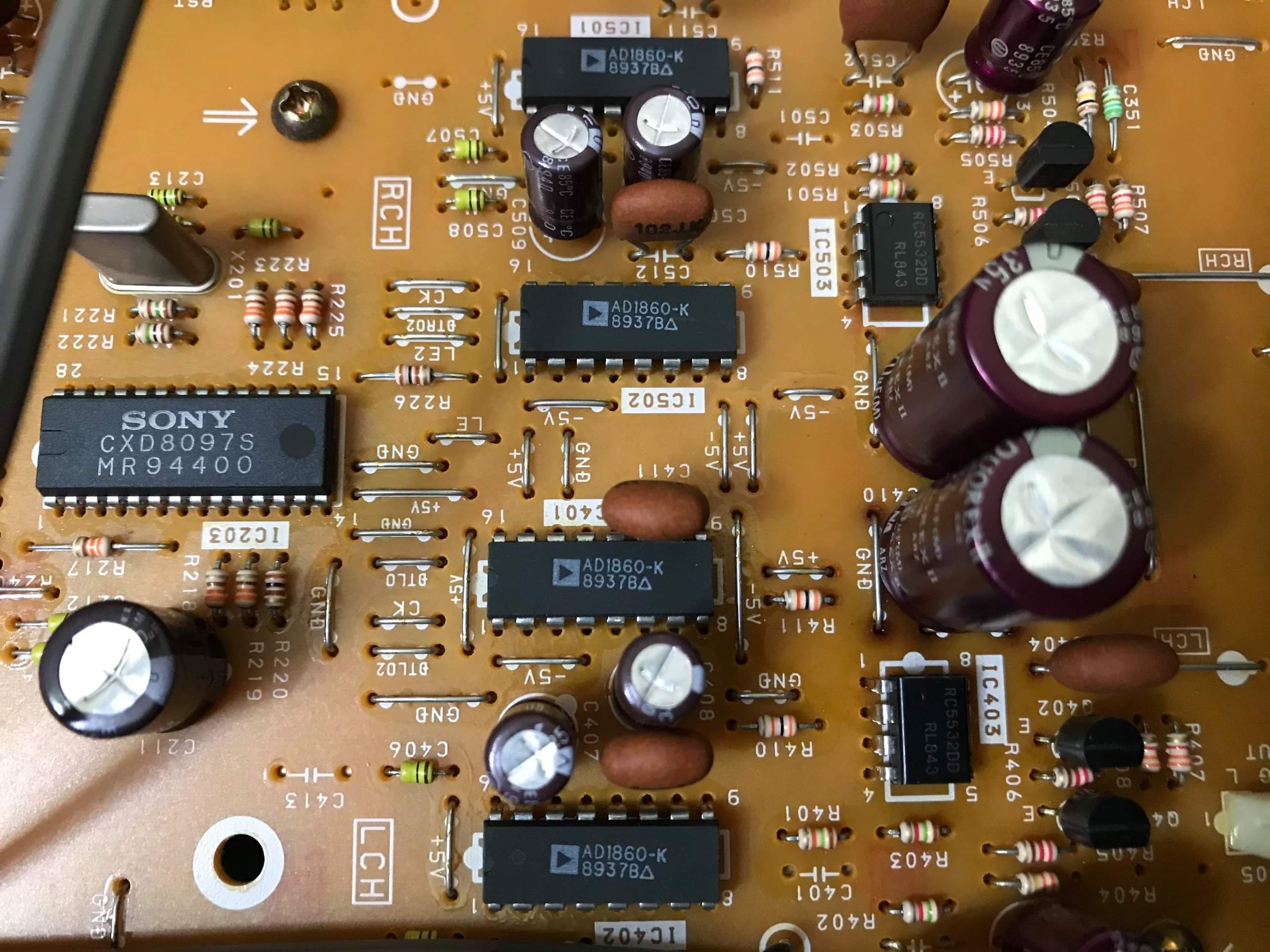

Can anyone tell me if these chips in the photo are the same asad1860n-k? The chips are printed ad1860-k. The datasheet of the ad1860N does not have this type. They are used in a sony player in parallel with 2 chips per channel. I am wondering why Sony did not implement dual differential mode.
