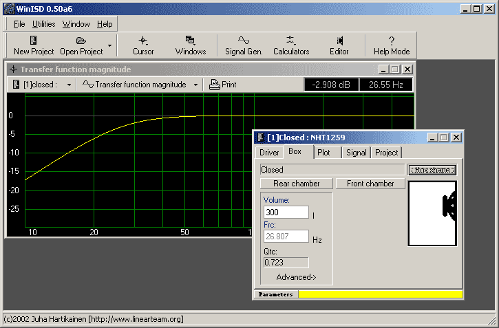

I'm trying to get the best sound for <$4k total so I'm cooking for a while a simple yet effective (I think) design, using:
- RD75 ribbon from B&G, one per 'channel' ( http://www.partsexpress.com/pe/pshowdetl.cfm?&PartNumber=264-700&DID=7 ) in an open baffle, separated from the woofer enclosure, used as a full range driver
- NHT1259 woofer ( http://www.madisound.com/nht1259.html ), two per channel, separate enclosure (300l+stuffing), powered by one amp per woofer unit ( http://www.partsexpress.com/pe/pshowdetl.cfm?&PartNumber=300-794&DID=7 ) - planning of getting rid of all the controls this one has...
- DAC/crossover (around 170Hz)/equalizing/alignement using Behringer's DCX2496 (of course 🙂 with capacitors/opamps upgrade): http://www.zzounds.com/item--BEHDCX2496
- ribbons powered with whatever good 200W+ amplifier I can get my hands on (I have Slone's OPTIMOS 200W units, should do the trick)
more on ribbons/linesources: http://t-3.cc/users/audioworx/page102B&G-Gallery&Links.html
http://www.snippets.org/alsr/index.php3
Any thoughts, ideas/bashing (like 'you also need two small (8")midbass (80Hz to 170Hz) drivers on the baffles to integrate the subwoofers with the main ribbon pannels')?
2x NHT1259 response in 300l sealed box. Add some stuffing and all will get better 😀
IMO for open baffle mounting of the ribbons you should be looking
at adding an Eq'd cone array to the necessarily reasonably wide
baffle for the ribbon.
2 8" are nowhere near whats required for smooth progression
from line source to sealed omnidirectional bass, I'd suggest 6
of these (with serious Eq) per side (6 for 5.3 ohm loading) :
http://www.partsexpress.com/pe/showdetl.cfm?&DID=7&Partnumber=299-431
and c/o frequencies ~ 75Hz and ~ 300Hz.
I can't see the ribbon handling 150Hz open baffle.
🙂 sreten.
