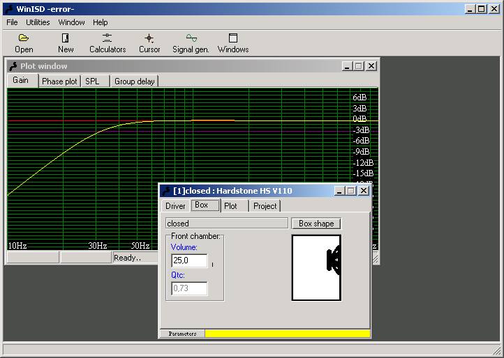

Hardstone HS V110 TS parameters
Here it goes:
Size - 250cm / 10"
Magnet weight - 80 Oz
Freq. resp. - 22-3000hz
RMS power - 375w
Max. power - 750w
Voice coil diameter - 2"
Sensitivity - 89db
Impedance - 4+4 ohm (I use the two in series for 8 ohms)
FS - 22 hz
Re - 3.6 ohms
Qts - 0.49
Qms - 6.16
Qes - 0.53
Vas (Lt.) - 31
Xmax - 20mm
What about this?
Interesting choice, thanks!
The winisd graph sure looks interesting (quite similar to the NHT1259 - I did some mistakes with my graph, both are -3dB@~30Hz in closed boxes, albeit this needs a smaller one) but it figures that it has a pretty high Le, so using it for more than 100Hz (the NHTs will go up to 300Hz with no problem) is a big no-no.
Yes, that's it, this one works very well in a small sealed box.
