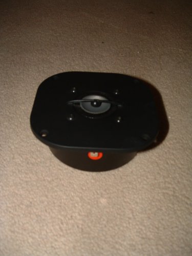

Tweeter - TC 120 TD5 (£53 each)
http://www.focal.tm.fr/gb/compo/tweeter/tc120td5.htm

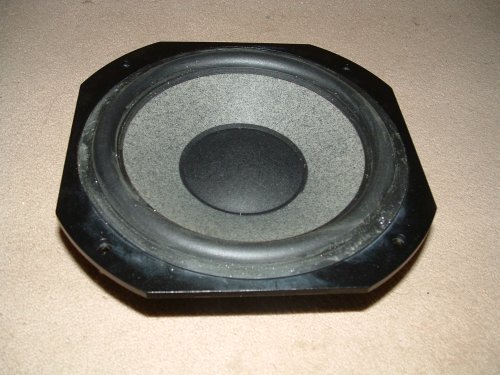

Woofer - 10 W 6411 (£150 each)
http://www.focal.tm.fr/gb/compo/woofer/10w6411.htm

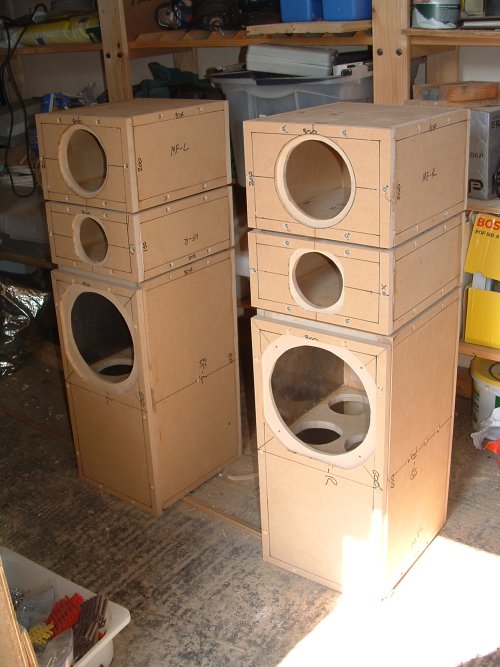

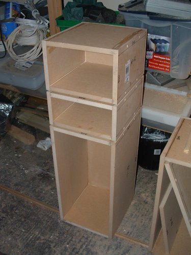

So thats the crossover and drive units sorted I am now currently sorting out the bits for the boxes. The design is going to look like the Triga speakers above that will consist of three completely independant boxes on top of each other. The sizes of these boxes (WxDxH) are as follows:
Midrange:
30cm x 34cm x 20cm
Tweeter
30cm x 34cm x 15cm
Woofer unit
30cm x 34cm x 60cm
The crossover for each of the drive units will be inside each respective box (makes the wiring a bit neater and also allows for biwiring ).
The boxes are going to be made from 18mm MDF which will be supplied from the local B&Q superstore which not only can they supply the MDF at a cost of around £30 they also can cut the MDF to size for an additional £20.
The Woofer and Midrange cabinets (not needed for Tweeter) are also going to be lined with "Acoustic Laminate Panels" and then filled Lambswool - All available from www.wilmslow-audio.co.uk
I am also considering lining the Woofer unit with grade 4 lead flashing (30cm x 3m from B&Q for £30) which is somthing similar to what JM labs do on their real high end cabinets (£30,000 plus units!).

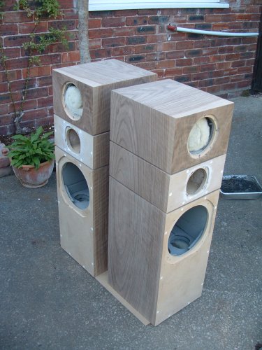

The cabinets are then going to be finished using real wood Veneer. I have managed to get ahold of some Eurpoean Walnut Veneer that I managed to get from a local company. I am going to need four "leafs" each measuring around 35cm x 2.9m and costing around £25/leaf.

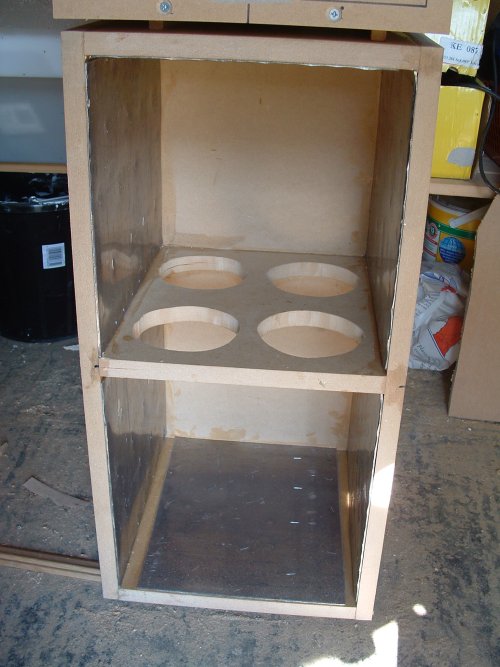

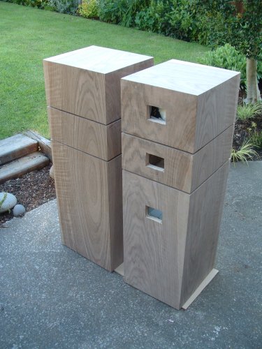

LaMa said:Looks promising, you are working fast.
Maybe you can put some additional braces to stiffen the bass-cabinet.
I agree. The speaker looks great, but I would stiffen it.
I like how the bass cabinet is created for this project:
http://home.hetnet.nl/~geenius/Andromeda.html
for a focal 13 series.
Brian
Joined 2002
I have thought about this and with the 150 screws, glue, grade 5 lead, 12mm achoustic lining plus the lambs wool thats going in I have decided that this will be enough.
I have found that when making speakers that 10% of your time is spent making the boxes and the other 90% is spent on the final finish. I really want them NOT to look like DIY speakers (if you know what I mean).
I think its a real shame when you see some of the units on here that people have built and they seem to have lost interest in the final stages (ie boxes just left unfinished and you can see the bare MDF).

attaching the veneer
I used the following method:
1) Make sure the MDF and the Veneer is completely clean
2) Apply "Evostick Instant Contact Adhesive" to both MDF and the veneer.
3) Wait for 10 minutes until nearly try
4) Push them together making sure that they are lined up 100% accurate - You cant change your mind with this glue!
5) Use a small woodern hand roller to make sure the veneer is 100% flat
6) Placed a large bit of spare laminate glass I had knocking around over the top and then place a heavy object on the top
7) Leave for 24 hours to dry
8) Using a Stanley knife I then *VERY* carefully cut around the overlap of the veneer.
I have also applied the veneer in the following order (as you look at the front).
1) Back
2) Top & Bottom
3) Left & Right sides
4) Front
This ensures that the 1mm overlap of veneer isnt visible on any of the main sides.
