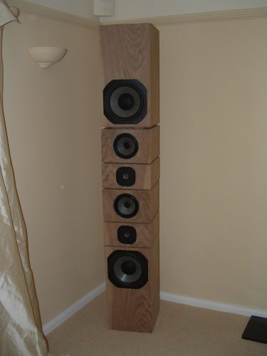

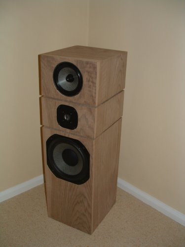

There was no backing on the veneer at all. Its not that difficult to work with, if anything I would say its easier than the backed iron on stuff. Just make sure you use "instant contact" glue and wait 10 minutes before you stick them together.
I am very very pleased with the sound. Its exactly what I wanted in terms of a clean uncoloured sound. The focal range are known for their "monitor" sound and these certainly are like that. The best thing I have found is that because the boxes are very heavy (due to the lead lining and laminate pannels) when I turn up the volume the bass is only really audible in the room where the speakers are, ie it doesnt "boom" downstairs or in any of the other rooms.
All in all I am very pleased (and she likes the look of them as well) - so 10/10 !

I didnt have any problems providing you follow these rules:
1) Make sure you use contact glue
2) Leave it to dry the correct amount of time before touching the two sides together
3) Use a woodern hand roller to get it as flat as possible as you stick the two sides together
4) Use a large hard flat material once they have been applied to ensure they are kept together - I also used a very heavy object (concrete bird table) on the top to keep them flat.

JasonL said:why is that bottom tweeter so close to the ground. are you short ?
What are the costs of each driver ? Where did you get them ?
Did you read the first post? It goes over the driver costs and where he got them. Parts Express carries the drivers as well except for the AudioM 6WM, which Zalytron sells for $155.
As for the tweeter height, it look pretty standard to me at ear level, but appears low, since the speaker is quite wide and tall.

It would look more normal with just one tweeter between the mids and sound a lot better too. Almost all I've read says one tweeter is the way to go- Otherwise all kinds of interference!
Look at the JM lab Focal speakers- always one tweeter even on the Grande Utopia

I am also building the Focal Triga and also use the tc120td5 tweeter instead off the tc90td5
my tweeters are now connected by a actie crossover so i can
experiment with the crossover frequence and the volume

JasonL said:maybe the tweeter on the top would be at ear level but not the bottom one.. Also those prices are In Euro not canadian..
Seth Smith said:Its not unheard of to use a non-earlevel tweeter mounting to help control and tailor the response of a non-ideal tweeter.
Variac said:It would look more normal with just one tweeter between the mids and sound a lot better too. Almost all I've read says one tweeter is the way to go- Otherwise all kinds of interference!
Can't you tell he's just messing around with a stereo pair

I have also used the tc120td5 instead of the tc90td5 driver but for starters I have kept the cross over exactly the same.
The trebble is slightly too bright due to the 120 being more sensitive than the 90 model so I have just turned down the trebble on the amp for now.
I would be very interested to know what the changes would be to the original Triga crossover design in the Hobby HiFi magazine.

Asdonk said:I will optmize the crossover for the tc120td5 tweeter
i think a few resistors will do, to get the tweeter about 3 db
down in sensitivity
for this problem I go to Speaker &co the local diy store for parts and kits and a lot off knowledge about speakers
ok great - Could you post up on here a GIF image or somthing showing what you have done - thanks!
