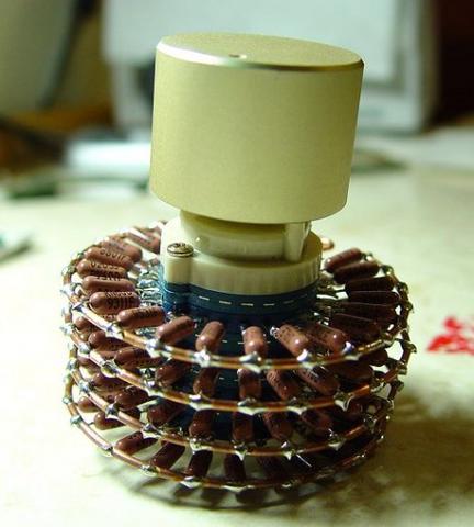

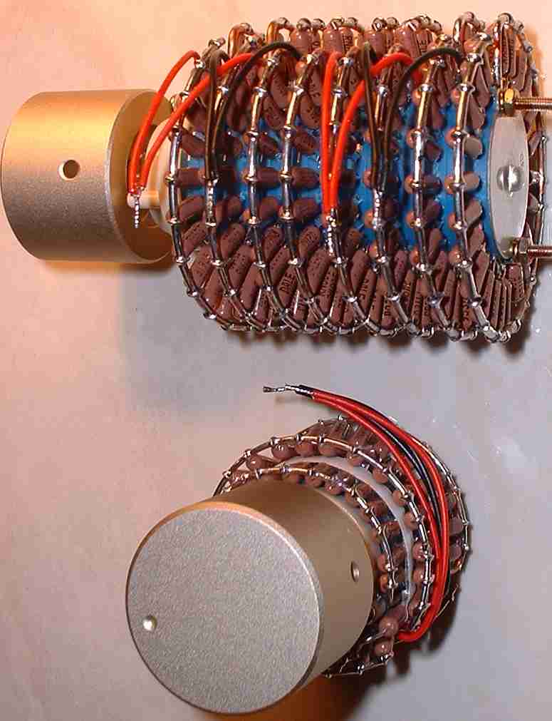

If you are getting the 4-layer attenuator, you'll need to get two of that - I'm assuming you want balance operation. Post #1 says only one is for sale.
Both are available now. BTW, both are 24-step.
You only need 4-layer to attenuate the input.
About the impedance, in my opinion, it might not be a good use in your application. Myabe I'm wrong, let the expert speak!
I assumed that Aleph 1.7 is also a balanced pre-amp and therefore for two channel operation, it would require either two conventional double-decker-VR or two 4-layer-attenuator. I prefer one 8-layer attenuator because there is only one knob to adjust both channel. I believe this is regardless of whether you're attenuating the input or output and me too I'm not sure about the impedance Aleph 1.7.
I used a 8-layer 10K attenuator for my BOSOZ - as I have posted several time on this forum - and it works wonderfully.
The input impedance on the Aleph P is 10K so the attenuator should be perfect. I don't understand why I would need an 8 section attenuator if I am just attenuating the input? I would think Russell is correct that only a 4 section would be needed. If the input and outputs were attenuated, then I would need 8 sections.
For output attenuation ONLY, 4-layer is needed for 2 RCA channels and 8-layer for 2 XLR channels

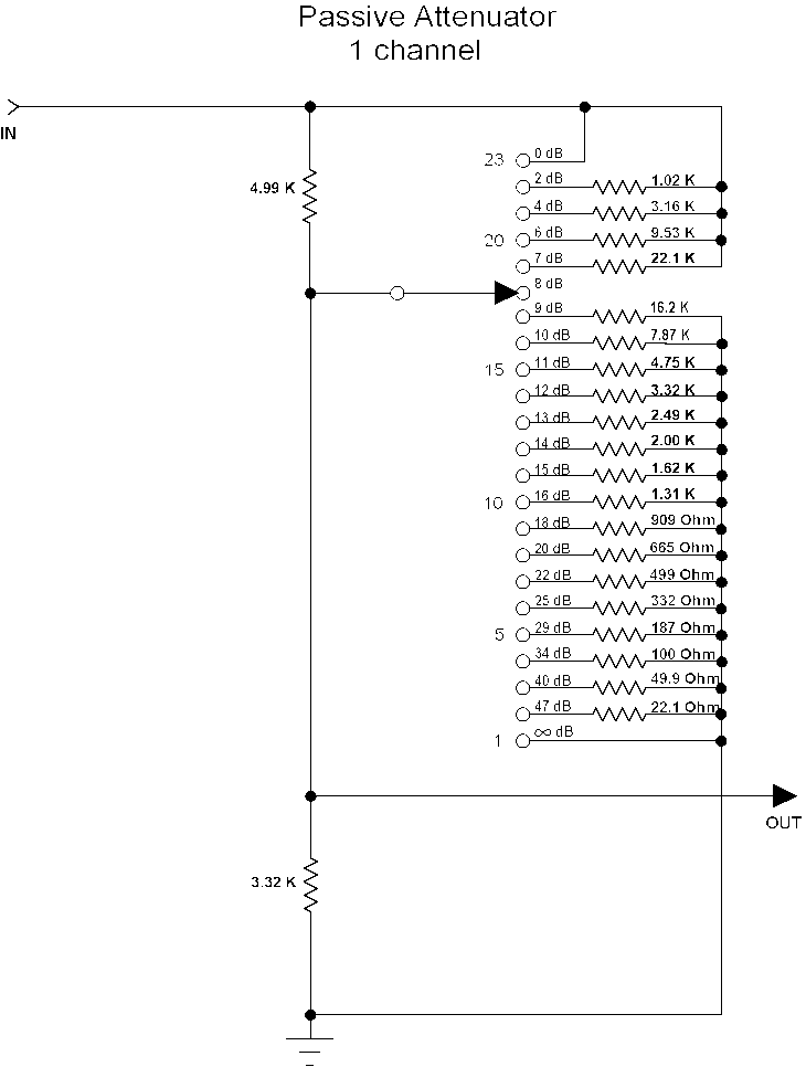

From looking at the schematic IHMO it seems that one device is for volume control and the other is to pre-set a relatively fixed output level so the volume pot operates over a "correct" range.
Operating both seems to add a lot of cost and little benefit.
The design looks like it might tolerate a fair amount of impedance variation so it could be possible to use a circuit that modifies either a fixed series or shunt element or both. Now only one layer (two per channel for balanced) is needed. You can afford a better switch and better resistors. The attached schematic (proud papa posted this once before) is not really the 10K average but illustrates the idea.
It's easy to scale the impedance, I wrote a spreadsheet that does it. Note that after building this I think 1 dB steps are overkill, 1 1/2 are probably about right.
If you use VR to replace DIP switch in original design for input attenuation only , you need 8-layer to control left and right XLR channel or 4-layer 2 RCA channel
