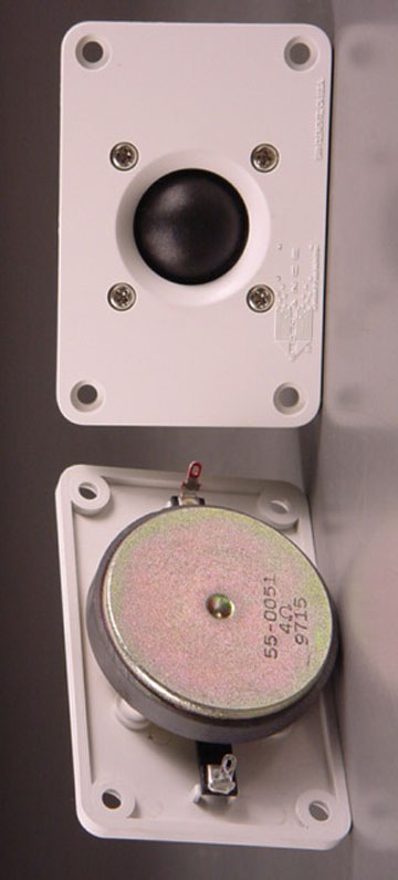

and here is the woofer section. It is 4 1/2" on the bolts. It also has the rounded square basket. It seems like an OK little project.
Cabinets have an internal of 1.7 litres.

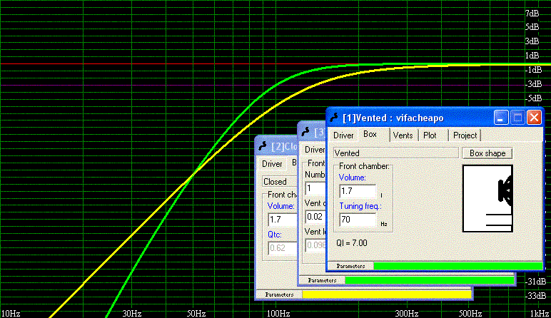

The port is a good idea. It would give you a little more low end you're looking for. Try modelling this set up in win isd...maybe I'll get to it first, watching a flick with wife right now.

Well, after playing around with the modelling proggy, it came up with=> 1.7L cab, 1.6" dia port 6" long = -3db at 110Hz...that's about the best you can do in this driver/cab arrangement. With some stuffing the driver will see a larger box and the -3db point should be lower, then you may have to play with port length to optimize, I estimate you can get <90Hz @ -3db. To get the ports (as calculated by win isd) to fit you can use two 3/4" ports 3.25" long. These modelling programs are only a guide, I've yet to hear a driver that sounds like a graph. I bet this combo would sound surprisingly good. I don't think you could do too much better in the bass department from a cabinet this small and I bet you can't get better imaging from a two way set up.
I'm guessing you really want to shock people with the huge sound coming from such a small box, IMHO good imaging impresses more than huge bass, most non-audiophile people never heard a speaker produce a believable soundstage, besides, I think this fullrange arrangement will produce more bass than expected to come from such a tiny box. Laff, I think I'm starting to sound like a salesman. This was the first driver to pop into my mind and I do not want you to be disappointed, let's keep hunting, maybe we can find something a bit better. Give it a couple of days.
IMO sealed all the way unless you want them farting on low bass.

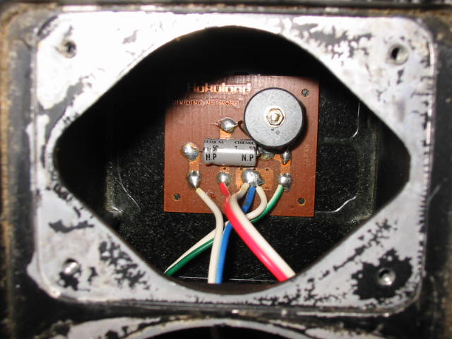

Using the existing crossover:
I will be cutting off the aluminum woofer at about 3000 Hz (6dB)
