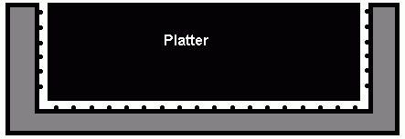

I remember a TT that was designed to float on mercury. I added an addition to the design that added a iol bath around the mercury bath to keep mercury fumes in. That design had a proposition to use a belt around the circumference, but with four bearings placed at equidistant points around the platter. If the belt is wound around the bearings it only touches the platter at four points around the circumference. That was designed to centre the platter without the use of a centre spindle. That leads me to my idea.
How about this for an idea:
1. use an air-bearing to float the platter, but don't use a centre spindle at all
2. put the platter in a 'well', with air-bearing nozzles similar to that used to float the platter around the circumference of the inside of the 'well'. That way air-bearing will not just be below the platter in order to float it, but also around it to keep it centered.
You can take this idea further and add vanes in the side of the platter, and then use the side nozzles to drive it.
For a brake you can use something similar to what Technics used in their SP10. They simply put a metal ribbon around the platter. The ribbon was fastened to the side and had a tightening mechanism. When the platter needed to be stopped, the mechanism contracted tightening around the platter. It is a very simple mechanism. In the idea above you don't have a centre spindle\bearing, so that can't be damaged by a system like this either 🙂
I hope my explanations are clear. I can see the idea clearly in my head, but trying put it in words is not so easy. 😉 I will try to add an image (this is my first time) to try and explain the concept.
Ok, if the image loads, then you will see the platter in the 'well' with nozzles all around for the floating and centering. Please note that this is a very crude illustration, but it is only meant to try and better convey my idea.
Enjoy,
Deon

Deon,
The floating platter idea has a major drawback; the energy can't get away except through the stylus mechanism of the cartridge.
That is, unfortunately, the last point of exit for any energy you'd want.
It's also one of the reasons this idea was dirched, the other being the poisonous nature of mercury.
BTW, airbearing TTs suffer from the same energy drain problem.
The only viable solution I can put forward is to still use a bearing but with only a small load on it as opposed to the full weight of the more classic approaches.
Can this not be addressed through the design of the platter? I mean, if you make a platter similar to the Teres ones (i.e. a few pockets in the platter filled with oil and bearings), will these not be able to absorb the energy and disappate it as heat? There may be another way to design the platter with internal components that eat the energy (as I wrote that I thought of the Duralube add that states that it 'eats the heat' :clown:) and disappates it as heat. The heat will easily be carried away as the air from the floatation passes over it.
Deon
There are a few things you can do but this often compromises the mechanical integrity of the system.
One approach is the use of an acrylic to augment the perceived mass of the record, acrylic being very similar in impedance to vinyl.
The addition of lead, oil and or bearing balls is to damp the self-resonance of this mass and to increase the rotational momentum, not to drain energy.
Converting energy into heat is not a big issue, what you want it to do is to stay away as far as possible from the platter surface.
Therefore a single point of exit is needed, the best way to provide this a mass-loaded bearing tip.
The surface area is small and the pressure provides an easy pathway out yet a difficult path inwards.
The idea of the tiptoes and cones as used under equipment is a direct spin-off of this theory.
