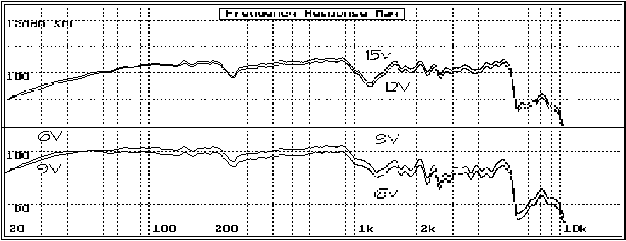

The PHL 3540 extended midrange seems nice, but I would recommend getting a frequency response plot for it, particularly for off-axis response. There is no indication of this on their website, that I can see.
The lower crossover frequency in a 3-way system should ideally be no higher than 350Hz, and probably no lower than 150Hz. A good compromise is either 200Hz (gets the entire voice fundamental), or 315Hz (gets good power sharing).
The upper crossover frequency should ideally be no lower than 3kHz, but can be as high as you like, as long as the drivers sum nicely on- and off-axis (including summing at a somewhat congruent phase angle, that should need only a constant delay to align over an octave or two).

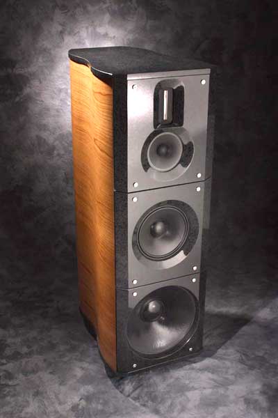

Have you heard which ribbon is being used in Von Schweikert Audio VR-11 (I think) with the two Scan-speak Ring Radiators?

Here is also a picture of curves of Supravox 400-EXC (It was used here with Raven R3.1: www.audio-consulting.ch/DescriptRefSpeakSyst.htm ) :

Do you think that Supravox 400-Exc would do the bass job from 250-25Hz? (expensive 650 $ or 900 $ for Electromagnet version )

The Supravox 400-2000 EXC is a Fantastic driver BUT it is a 16 inch diameter driver (and that doesn't meet the requirements you posted). This of course is why I mentioned the TAD drivers..
If configured properly w/ very good amplification your sytem will be MUCH better than 10k+ systems, but with parts alone it will still be VERY costly. (and yes the G1 will trounce anything I can think of except the Raven R3 which costs more than 3 times the price.)
Note however that amplification is almost as important and can be far more costly. This is espcially true if you go active, requiring an amp per driver.. (Marchand makes very good active crossovers). Try looking at Transcendent Sound's new SE OTL (they even ship abroad), with a 101 db eff. you could use 2 of these amps for the mids and tweets in an active configuration. For the low freq. units I'd go with his T-16, BUT because its an OTL you'll need to series connect the 2 bass drivers.
