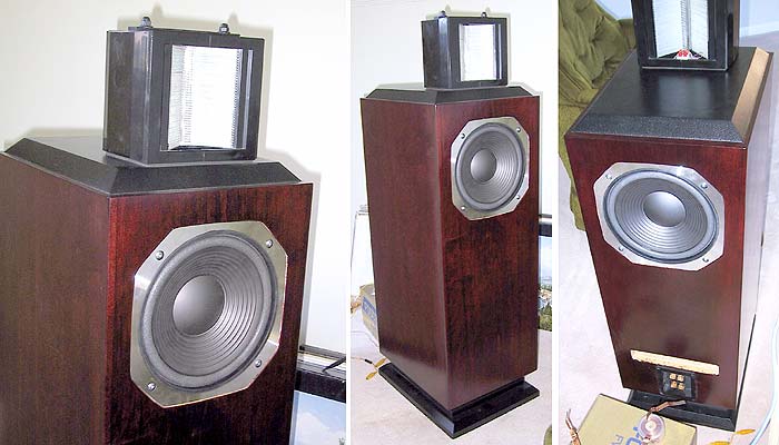

jonk said:AR2: how much baffle step did you get with the 3450 on that small baffle of yours (nice job on your speakers BTW)? What slopes are you using between the PHL and the ESG’s?
I am using tri amping throught the active crossover, so there is no baffle step compensation. The slopes are 24 dB.

Right, BUT the Supravoxes act as both a midrange and a bass driver when utilized in a T-Line (i.e. just 2 drivers + the G1 per loudspeaker). Where as the PHL mids are just mids and need bass drivers.

ScottG said:Right, BUT the Supravoxes act as both a midrange and a bass driver when utilized in a T-Line (i.e. just 2 drivers + the G1 per loudspeaker).
That is thinking along the same lines as we were oing listening to the visaton B200 on Saturday -- it has highs, but the sweet spot gets pretty narrow... one (or 2 in a bipole) XOed to a ribbon and you'd be sailing.
dave
Bipole wouldn't provide the neccesary eff. at the cross point for the G1 (it would however at around 300 Hz.) In otherwords you would have a depression in output between 300 Hz and the cross point at 1800 Hz with a bipole arrangement and these woofers.
