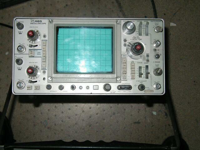

Without a doubt, I would recommend the Tektronix 465 100 MHz Oscilloscope. A rugged industry standard with lots of them on the used market. Mine has appreciated in value since I bought it. An oldie but goody that I would never part with.

Trust Harry for an answer. I 've been using a 750 MHz Tek digital phosphor oscilloscope from work which is probably better than an anlog scope (unlike the TDS 210/220 junk) but the last reserve unit is being integrated into a permanent setup. I like tek! In my previos job I had a Tek DSO for fast stuff and an incredibly versatile Hameg for analog. Anybody know Hameg outside of Germany?

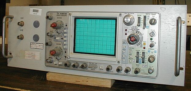

I have a 465B that I don't need anymore. If anyone is interested
let me know. It is a rack mount uinit but can be taken out if desired. The B series is the one you want.
