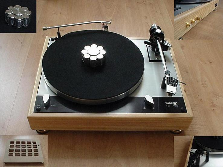

Finished modifying Thorens TD 160!
Just finished modifying my Thorens TD160.
This is what i've done:
1 - New plinth made of propper wood
2 - New bottomplate made of 15mm MDF
3 - Dampened the chassis
4 - Dampened the Subcahassis
5 - Placed seperate Ground connection
6 - Placed new cinch sockets
7 - Placed new power socket
8 - Placed new armsupport
9 - Cleaned all bearings and oiled them with teflon
10 - Made a stabilizer
11 - Placed dustbuster
12 - Set and adjusted everything
Anything else i can do?

I first dampened the chassis, and then the subchassis. After that i placed the stabilizer. Then i putt in the new cinch sockets. The next step was more drastic, did it all in one go. Made a new plinth, bottom plate, seperate ground connection and power socket.
After the first step the sound had much improved. Step two, not much difference. Stabilizer improved the sound, made it more "pure" (for lack of better word). Cinch sockets allowed for a much better interlink (monster cable), which made the music realy come to life. For the last step i can't truly say if the sound has improved much, it took me about 2 months to complete (don't have that much spare time). All i can say about it is that looks have improved very much! And it still sounds great!
The tonearm is deffinetly the next thing i would like to modify, i'm thinking about a carbon fibre arm with a lighter headshell.
This will make the arm lighter, and thus improve the response of the tonearm. Maybe in time, i'll get another cartridge to.
