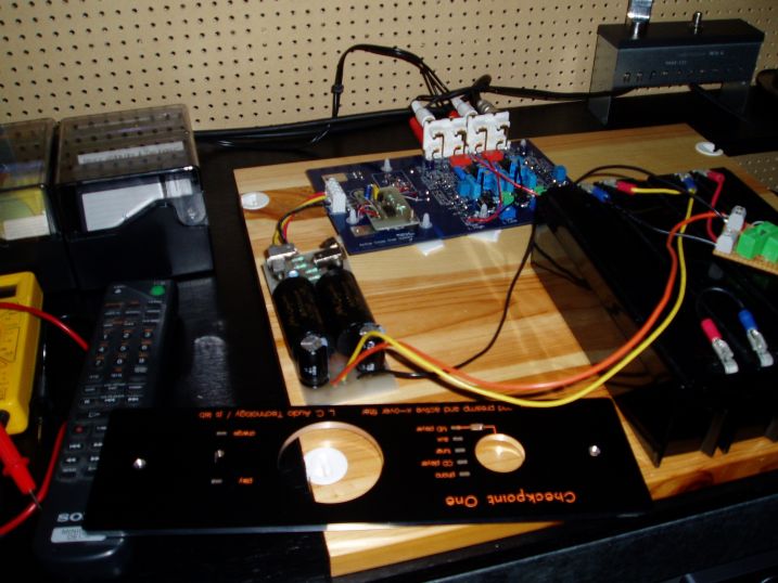

I'm working on a project, where I will keep the cirquits heated by traditional power while I'm charging my batteries and then switch to batteries when playing. I plan to put batteries to my preamp, my active x-over and my RIAA-MC preamp.
Jørn
on the picture you see my current battery powered x-over (L C Audio - modified)

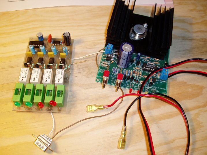

Sure - my addition is, that I designed a kind of mutiplexer, so I can charge 4 x 12V batteries in series one by one using only one charger.
"but the question is, is it worth the additional complexity?"
I think so - the circuits will stay heated, and there will be no warm-up time - in my opinion this will give the best performance.
On the picture: left - slow multiplexer circuit - 15 minutes pr battery) / right - charger (Velleman kit)
Jørn

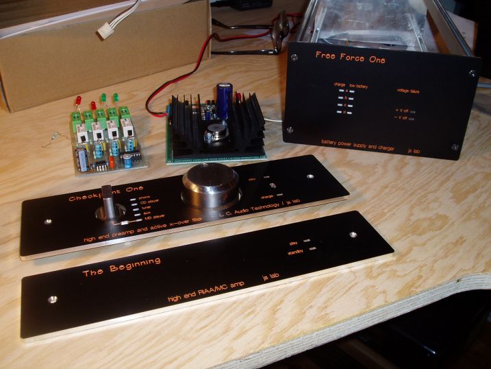

on the picture: frontpanels from Schaeffer Apparatebau, Berlin
