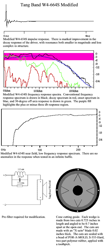

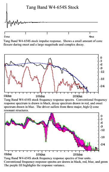

As I have stated previously, I like Tang Band. They make small diameter drivers that have the possibility of nearly full-range operation. Indeed, a couple of their products have promise. Here is the promised modification to the Tang Band W4-654S driver.
The goal of this modification is to produce a driver with near high fidelity levels of performance. At a minimum, this includes a frequency response that does not exceed plus or minus 3-db. Any resonant structures or performance anomalies that prevent achieving that plus or minus 3-db rating are considered problems.
In stock condition, the Tang Band W4-654S driver has problems. As those problems are complex, the modification is complex. The modification is made more complex because the cone material is paper. The chaotic vibrations of this cone in resonance cannot be controlled by conventional means of applying materials of differing characteristics across the surface. Instead, I have taken an approach where you isolate important cone surface regions for the chaotic vibration behavior in resonance.
Eight narrow slits are made in the cone, forming four Vs. The placement of the slits is shown in the cutting guide. The slits are then sealed with a synthetic rubber compound applied with a toothpick. Very little of the rubber compound is used. Its purpose is to seal the cone and allow it to act as a coherent surface while preventing the origin conditions of the resonant structures. Only the specified rubber compound precisely mixed to manufacturer recommendations will achieve the results shown.
After modification, when mounted in an infinite baffle enclosure, the driver performance is from Fs to 15 kHz, plus or minus three db. Over the critical region the response varies by only plus or minus 2.125 db. The driver now comes very close to high fidelity performance criteria. The design fails to reach 20 kHz by only one-half octave. The roll-off in the high frequency stop band is smooth and well controlled. If you try to crossover to a “super” tweeter, no additional filtering is required for the W4-654S.
There are three complications to adding a super tweeter. The high pass filter on the super tweeter will have to be a high order design to match the W4-654S’ roll-off. The second difficulty is finding a tweeter with significantly better high frequency performance than that of the W4-654S. I have a number of tweeter evaluations posted on my Web site (http://madspeaker.com). When examining onset response, they are rolling off in the same region as the W4-654S. Lastly, because they will not perfectly sum transiently, adding a tweeter will reduce the coherence of the W4-654S.
Over the next couple of weeks I will post additional modification details to my Web site. As other Tang Band modifications are completed, I will post them to this thread.
The attachment to this message is the stock performance. The second posting will contain the modified performance and modification guides.
Good luck and have fun,
Mark

As promised (and to hopefully save this forum's bandwidth) I have added the modification page to my Web site. I have included a photo of a modified driver to show that extreme precision is not needed in applying the synthetic rubber compound. I have added a source address for the rubber compound. I have also added a before and after comparison graph of frequency and decay response.
You can use this address (http://madspeaker.com/Projects/MADMODfour.htm) to reach the modification page while avoiding all of the commerical aspects of the Web site.

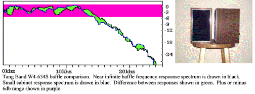

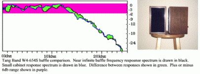

baffle comparison
I have attached the large (nearly infinite) baffle to very small baffle frequency response comparison graph. The small baffle box measures 5.875 inches wide by 9.875 inches high by 6.625 inches deep. All box walls are 0.5 inches thick. Both measurements were taken from one meter. Drive voltage and microphone gain were held constant. The small baffle box was tightly packed with high-density foam. The small baffle box was elevated on a stand in the center of the room. The data window was truncated to eliminate boundary reflections from walls, floor, and ceiling. The driver had stopped voicing before the end of the 6 ms window.
The small box frequency response of the same W4-654S modified driver differs from its response in the infinite baffle. From 800 Hz to 3 kHz the small box response is up. From 4 kHz to 8 kHz it is down. From 8 kHz to 12 kHz it is up, and from 13 kHz on it is down in comparison to the nearly infinite baffle response. Fs is also higher in frequency in the small box (about 90 Hz).
The small boxes pictured here were artifacts from my high school days. I bought them from Radio Shack. They came with four-inch drivers that were not extended range. I was still using them for producing background noise to mask my computer’s fan noise. After installing the modified W4’s I now have a pair of unusually high fidelity background noise sources. If I were going to use them for serious listening in this small of a box, I would increase the Q on the specified pre-filter and add a second notch filter at 12 kHz.
It is difficult to determine cause for the measurement differences. My hypothesis of cause is diaphragm loading by the internal small box air mass and internal reflections.

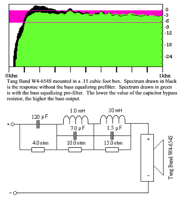

W4-654S in a small box: A design exercise.
The small box pictured above, measuring 15 by 17 by 25 centimeters with an internal volume of .15 cubic feet, is not the optimal enclosure. If, however, you have a need for a loudspeaker in a very small box, this is a possible solution with fairly good fidelity. Compared to a larger enclosure, the required pre-filter is more complex and more expensive. This small loudspeaker is most lacking in bass extension. Fs is about 160 Hz. Yet, because of rear loading, without the pre-filter, the output is still rising even below Fs. With the pre-filter, F3 is below 100 Hz. There is no ripple or other anomalies in the response. You cannot, however, beat physics. Distortion levels below Fs are high.
The attached graph shows the near field response (microphone placed 12 cm away from driver, data truncated at 25 ms.
With the small box pre-filter, I can listen to these loudspeakers. I can even seriously listen to them. I notice the lack of bass extension, the higher distortion, and coloration of some mid bass sounds. I also notice better than average clarity and detail in the midrange and treble, and a defined soundstage dependent upon the musical selection.
Mark
