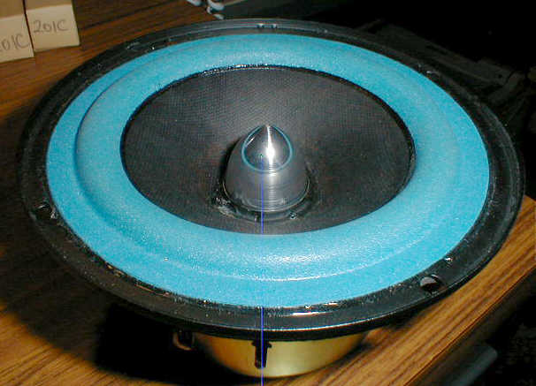

Here is an update to the Tang Band W4-656SB modification. While I am including a link to the graph section of that modification, the accompanying text is still in its own thread.
I am trying to more precise reproduction accuracy, and that means going after vibration structures that are smaller and even more chaotic. The more you strive for that last little bit, the more precise the modification must be.
In this update, I try to minimize the remaining 9 kHz peak and to minimize a 4 kHz vibration structure that is visible only in the decay spectrum. Both structures are trickier than the 7 kHz structure with more complex cone motion.
Six narrow glue arcs are required to minimize the two vibration structures. Each glue ring is formed from a 1 mm diameter bead of Gem Tac glue. The 4 kHz structure is handled by three arcs three mm in from the inside radius of the surround. Each arc is 3 cm in. The mounting holes are uses as reference points to center the arcs. The longer arc should be between the two shorter arcs.
The nine kHz peak is handled by one glue arc 11 mm in from the inside radius of the surround. This glue arc is 3.5 cm in length. This center of this glue arc is marked by the remaining mounting hole. The last two glue arcs are 12 mm in from the inside radius of the surround and each is 2 cm in length.
Just to make a point of the arbitrary nature of plus or minus ratings, with mod two, holding to the plus or minus zone of mod one, the driver has a bandwidth of 72 to 14 kHz. If, however, we base the plus or minus range to the new driver response, then the modification driver will have a bandwidth of 68 to 15 kHz. This is shown in the mod one to two comparison graph by the dark purple offset range band.
Good designing and good building,
Mark

There is great potential in having frequencies from mid bass to mid treble reproduced by one coherent driver. The TB W4-656SB, when modified, is one great performer over this bandwidth. Indeed, while the W4-1052SA has more high frequency extension than the W4-656SB, from mid bass to mid treble, the W4-656SB is the better performer.
In case you were holding off on the W4-656SB because you do not have a lathe to make the phase plugs, here is an inexpensive and fairly easy alternative for only a minor decrease in the performance.
Go to a hobby or fabric/crafts store. I bought my supplies at Jo Anns (I could be wrong about how you spell the name). I bought two packages of wood shapes at .98 US dollars each (98 cents each). I bought one package of 1 inch wood discs, and one package containing three one inch by 1 and 1/8 inch wooden flower pots. Stack and glue four of the discs, and add one inverted flower pot to the top of the stack.
The machining on these wood novelties is not precise. You need to hold the maximum diameter to no more than 24 mm. Some of the novelties are under that diameter and most are slightly over. The part of the plug that is likely to be too large in diameter is not particularly important for performance as long as the voice coil can move freely. You do not have to have this portion perfectly round.
You can sand the base of this inexpensive plug by hand, just make sure that the largest diameter is no more than 24 mm. With 100 grit sand paper, it should take no more than 2 minutes of sanding per plug.
I have included a photo of the parts for one plug and a completed plug. I have also included a graph comparing the frequency spectra of the machined plug and the flower pot plug. Of course, all of the mod 2 changes should be made to the cone and you should use the mod 2 prefilter.
Mark

Mark,
In my own case I am not 'holding off' on making phase plugs for my TB W4-656's for lack of a lathe. I do have a metal machine shop and show a solid aluminum phase plug I made for another driver as an experiment a few years ago. I am eager to experiment with these TangBands but am very preoccupied on another major loudspeaker project at the moment and want to wait on the TB until I have adequate computer based testing capabilities set up to 'see' what is going on like you can.
Rob
