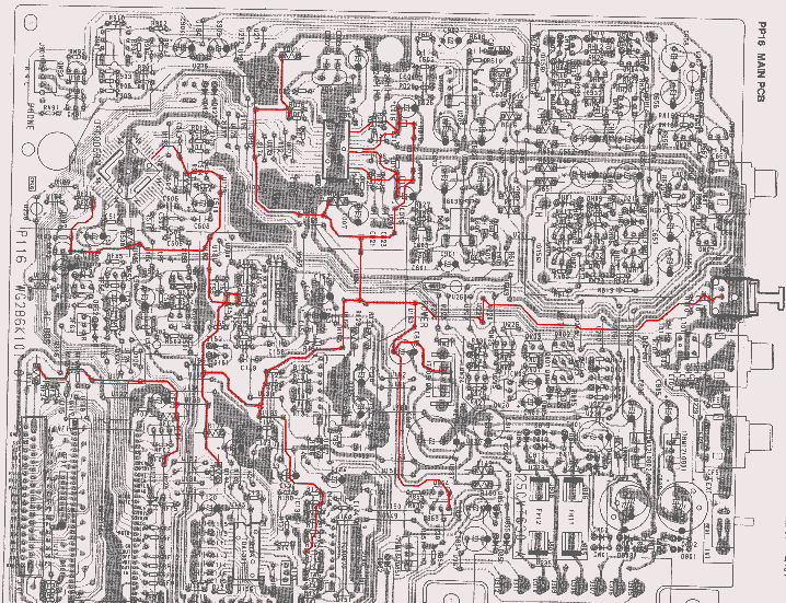

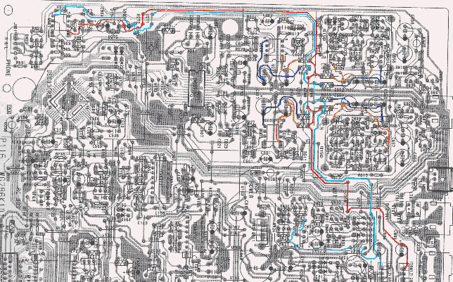

I also have some scans of the main PCB tracks, with the power supply traces highlighted (5V, +12V and -12V) for those that fancy tweaking and adding additional regulation, it makes it a lot easier to follow.

You may find the following useful, it traces all (If I haven't missed any) of the 5V and +/- 12V rails through the PCB.
I suggest feeding the DAC analogue from a regulated supply is very worthwhile, but do the DAC oscillator supply first - it will make a bigger difference, the 5V supply rails are VERY noisy.
Andy.
