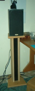

Here are my stands, they are solid 32mm MDF all over, the inside piece is sprayed black and the whole thing is awaiting a polyeurathane spray that will darken the whole thing up and make it look nicer. the centre pieces are glued together with PVA and the top and bottom are screwed on with 4 long screws each. the whole thing is very rigid and can easily take my weight of 85kg.

Raw MDF cut in 800 by 120 mm pieces with top and bottom plates. Screwed together without glue and free hand. Stem is 3 pieces as a U shape open in the back. Total cost USD 6 including screws. Estimated building time was just under one beer.
