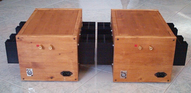

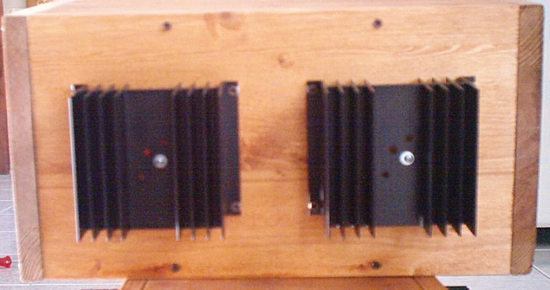

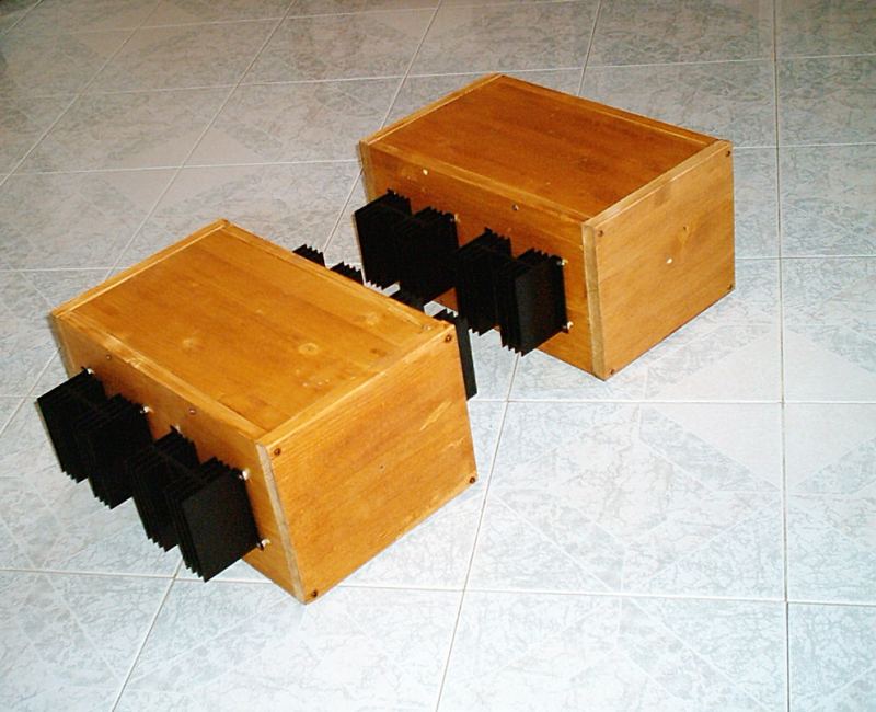

My own X-Zen monoblocs are running at 2.7A each and uses Aleph current sources in the upper zone of the differential pair, and a constant current source at the tail. The CCS works at 5.2volts and at the output points there are 21.7 volts . The supply is fixed at 38V.
Signal and Aleph CS Fets dissipate around 21.5W and the sinks temperature is actually low.
DC offset between the speakers terminals is 2 or 3 mV.
Design reflects the JH6you one in the x-soz thread but I introduced a CCS instead of resistors at the tail , for a better X effect and low dissipation.

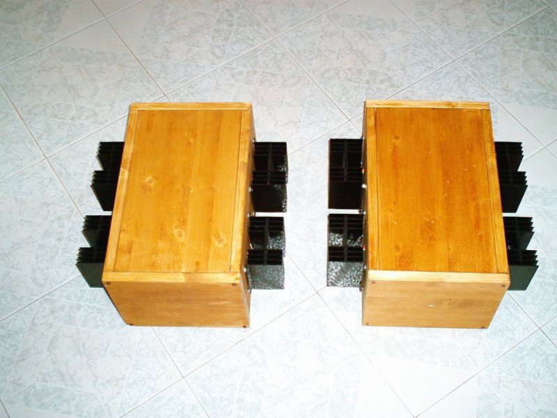

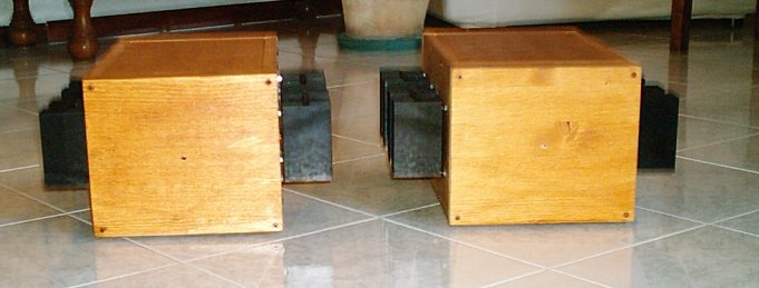

The pics show my own realization , based in a wood box + separated heat sinks for each fet so I've been able to avoid insulators between fets and sinks.
There is a fully simmetrical lay-out in terms of pcb and cables lenght, and I have selected the devices for a match of 15mv max vgs.I do not have very good parts though , especially power resistors , but I am happy with they anyway.
Schematic reflects the circuit as I build It .
The babies.....:

blank527 said:Cute!
Do you like the sound?
Remco
Thanks , blank527 . Yes I like the sound veeeery much!!!

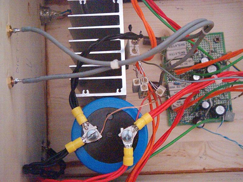

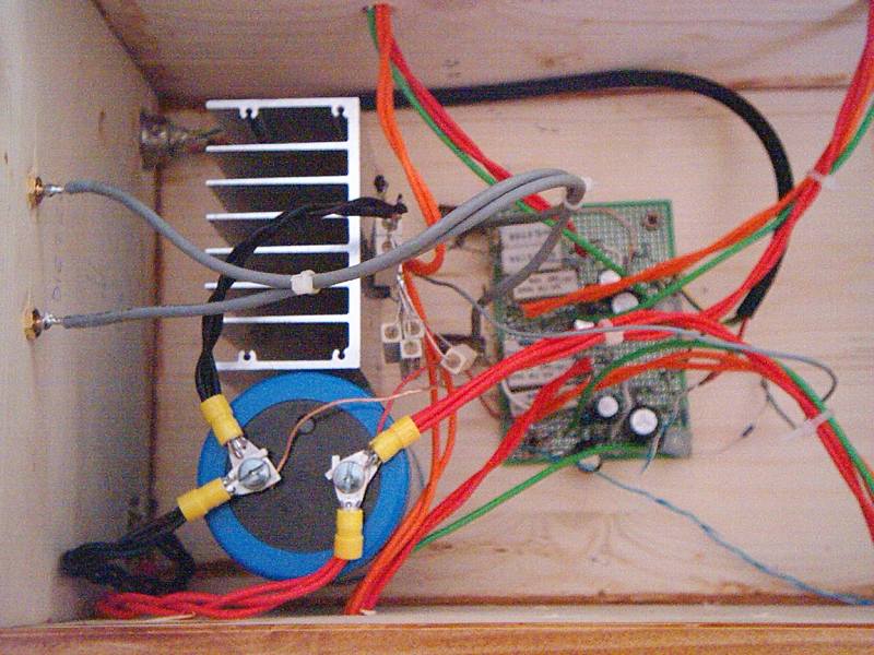

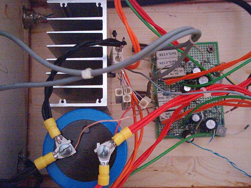

An eye on the inside...
On the small heat sink is mounted the Fet for the CCS; the capacitor is a nippon chemi-con 56000u -50V ;Necessarily I mounted some resistors in parallel to achieve the wanted dc point.I also introduced -see the Aleph X schematic-the famous "mills resistors" at a value of 22k.

stappvargen said:Great job stefanobilliani.
You have just inspired me to make a similar effort!
How do they compare with your ZenV2 (I think)?
/Niclas
Thank you Niclas,
I have Zen V4 with IRF9610 buffer; comparing the 2the results are:
sounstage focus ,
punch ,
timber precision,
power into 8 ohm.
All are greater with X , and the sounds slide with more fluidity.
Well : when the music plays those aspects are all in a great cohesion ... and I forget myself about they.
/Billiani - still likes his Zens
