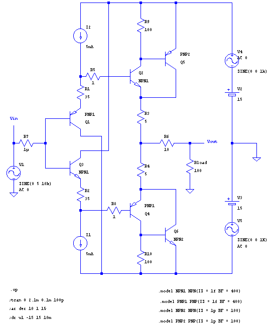

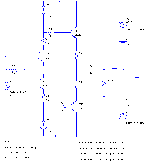

Below follows the circuits I simulated. First the standard buffer
Note that the BJT models used for the input stage are intended
to be similar to small-signal devices and those for the output stage
similar to power devices.

And here is the CFP version. I use the small-signal type of BJT for
the "drivers" of the CFP pairs, and the power type for the "boosters"
(or output devices).
Also note that for both buffers, the pairs are perfectly complementary
by using ideal models.
Further note that I had to increase the emitter resistors in the input
stage to get approximately the same bias current in the output stage
for both cases. Both buffers run in class A with approximately 34mA
quiescent current through the output emitter resistors.

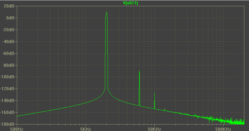

I used an input source of 5V pk, 10kHz in a 100 Ohm load (or 110
Ohm if one counts also the 10 Ohm "isolation" resistor) in order to
get rather high distorsion figures. The simulation was done using
a 21 cycle transient analysis, discarding the first cycle, and with a
mnimum time step of 100ps. I then ran a FFT on the input and
output signals using 0.5Mpoints and no windowing. There is no
trace of even-order distorsion at all when using perfectly
complementary transistor pairs, which concurs with earlier
experiments I have done on the effects of mismatching transistors.
The odd-order distorsion for the standard buffer is approximately
as follows:
3rd: -79dB,
5th: -106dB,
7 th -132dB
and the spectrum looks like this

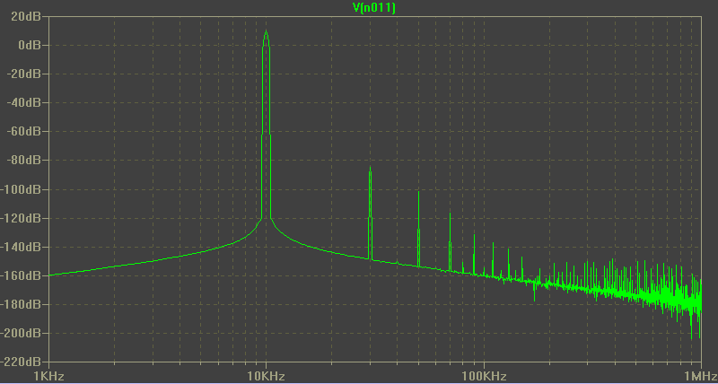

For the CFP version the distorsion figures are
3rd: -96dB,
5th: -112dB,
7th: -128dB
and the spectrum looks as below. There is more noise in this case.
For some reason the noise is present already in the input signal
which I don't quite understand since Spice uses ideal voltage
sources. Maybe it is some roundoff errors or some FFT artifact.
Hence, the higher order products are less reliable here, but we
clearly have a lower 3rd order distorsion than in the standard buffer,
but maybe there is a tendency towards slightly higher values for
high-order harmonics. The latter could be due to the noise artifacts
too, though.
Furthermore, please note that these are not to be treated as
absolute figures reflecting a real circuit, but only an attempt to
study the relative effects of followers vs. CFP outputs.

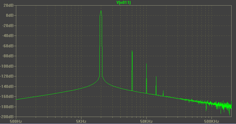

By popular demand, well from Pavel at least 🙂, I decided to give
my computer a rude awakening and run another 2 hour session.
I increased R1 and R2 to 60 Ohms in the standard version of the
buffer (ie. not the CFP version). This approximately doubled the
output stage bias to 72.4mA and it thus runs very very much in
class A, the current through the output devices now stays above
50mA all the time under the same conditions as the previous runs.
As expected, this improved the distorsion figures, which are now
3rd: -99dB,
5th: -137dB,
7th: -164dB
and the spectrum supplied below.
Note however that the comparison is no longer fair since both
buffers were biased almost exactly to the same current in the
previous runs. Doubling the bias current for the CFP version would
most certainly also improve its distorsion figures. However, this
may indicate that for low-level applications it could be better to
use the standard variant and dissipate some more power than
to increase the circuit complexity and risk stability problems etc.
In these examples each output device dissipates 0.5W at the
lower bias level and 1W at this higher level.

and I am in reasonable agreement with your numbers for the 3rd and 5th, the 7th is below my horizon, as didn't want to run for hours.
And more interesting. Looking for devices with 1E3 ratio in IS, I simulated with 2N3904/2N3906 and KSA1943/KSC5200. And the results stay the same mostly. The 2nd harmonic exists, but is about 18dB lower than the 3rd.

Good that it could be reproduced. Actually, I got rather good
figures for the standard buffer with shorter runs, but since the
CFP one had so much loewr distorsion and the noise floor was
worse I had to extend the simulation. To get comparable results
I ran long simulations for both. I have earlier experimented with
the standard buffer and the same ideal BJT models, and studied
the effect of mismatching BF and/or IS to see how that affects
the results. With matched devices there are no visible even
harmonics
at all, as you can see. When mismatcing BF or IS a factor two for
the output devices the odd order distorsion stayed almost the
same, but even order distorion appeared. I don't remeber the
figures right now, but have posted them earlier in other threads.
I think I got second order distorsion on about the same level as
the third order. Since real devices are not perfectly complementary
the even order distorsion should show up, as they did in you
simulation.

Hi Christer, All,
More simulation results!
Now I've done your CFP schematic in post #3
http://www.diyaudio.com/forums/showthread.php?postid=309440#post309440
3rd: -96dB,
5th: -112dB,
7th: -128dB
I've got these numbers, which are in good agreement:
Harmonic Frequency Normalized
Number [Hz] Component
1 9.766e+03 1.000e+00
2 1.953e+04 3.293e-10
3 2.930e+04 1.888e-05
4 3.906e+04 3.653e-10
5 4.883e+04 2.637e-06
6 5.859e+04 3.499e-10
7 6.836e+04 4.266e-07
8 7.813e+04 3.623e-10
9 8.789e+04 7.333e-08
Total Harmonic Distortion: 0.001907%
Judging from a DC sweep, the load sharing between
Q2/Q4 and Q5/Q6 changed at about +-3V, so I changed
component values for a more 'linear' behaviour.
R1/R2 => 33
R3/R4 => 3.3
R9/R10 => 220
This gave a fine improvement, and we are towards
the 120dB figure you gave later.
2 1.953e+04 3.759e-10
3 2.930e+04 2.160e-06
4 3.906e+04 3.338e-10
5 4.883e+04 6.192e-08
6 5.859e+04 3.714e-10
7 6.836e+04 3.259e-10
8 7.813e+04 3.337e-10
9 8.789e+04 1.675e-09
Total Harmonic Distortion: 0.000216%
Now I changed to real virtual devices: BC547/BC557 and
KSA1943/KSC5200. K3 doubled and the even order harmonics appeared. Still very good results.
2 1.953e+04 1.698e-05
3 2.930e+04 4.272e-06
4 3.906e+04 7.260e-08
5 4.883e+04 8.747e-08
6 5.859e+04 3.590e-09
7 6.836e+04 5.842e-09
8 7.813e+04 3.187e-09
9 8.789e+04 3.216e-09
Total Harmonic Distortion: 0.001751%
SPICE trivia:
Building upon advice from the LTSpice mailing list, I used following Parameters and was able to resolve down to -160dB with less than 2 minutes simulation run time.
V3 N011 0 SINE(0 5 9k765625) AC 1
.tran 0 5.12m 1.024m 0.015625u
.fourier 9k765625 V(out)
The parameters for the graphical FFT were
262144 points
Hann window
5 points binomial smoothing
Graphical FFT and .fourier outputs are in good agreement.
