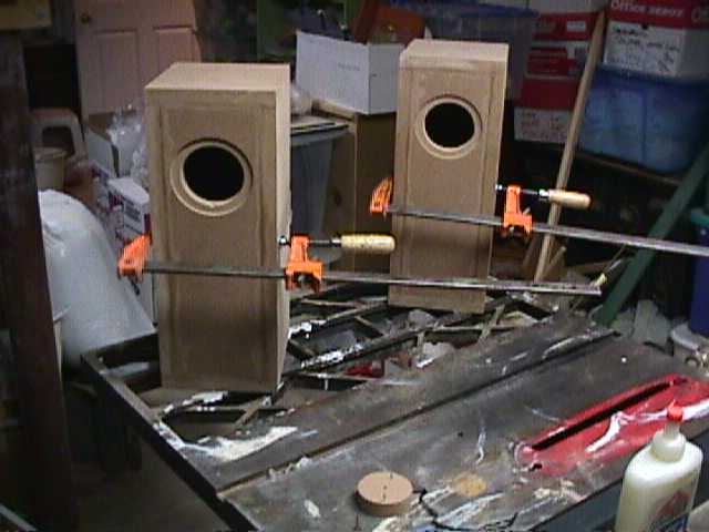

I just finished my 871s. These sound very nice and have lived up to the hype that I've read about. These will probably be delegated for computer use as I'm planning on building a small line array system with the 871s (4 per cabinet).

Very nice. Is that hardwood for the front baffle? Ported or sealed? Did you use any electronics?
Thanks. Yes that's hardwood for the front baffle. It's Padauk, an african hardwood. The box is sealed, based on John's design http://home.new.rr.com/zaph/audio/audio-speaker11-box2.gif. No electronics at this time. I didn't use John's notch filter either. Since I'm using as a small HT system I didn't bother with a high pass filter, I have my preamp set to "small" 100Hz cutoff.

Beautiful job, kec. Another question for you - what's the black finish? Texturelac? Truck bed liner? Looks sharp.
Thanks dooper. Truck bed liner paint. Here's a few more pics TB 871s

i wish i could take credit for the design i used (cause naming my own speaker would be interesting), but i just copied the apparently tried and true design from John's Audio Projects (a couple of us have posted the links). except for the fact that i used 3/4" mdf instead of 5/8" (couldnt find any 5/8 and had tons of 3/4 from car audio projects), its identical. but maybe i should start naming because its slightly different......😀
