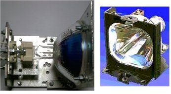

I think the trick will be to
1.trick the projector into thinking the bulb is fine
2.Focusing the parabolic reflector from the old bulb with you new, cheaper replacment. Kinda like your picture. this would give you about the same ansi lumens (assuming the bulb your using has the same lumen output as what its replacing)
3.Fit you cheaper and probally larger bulb into the space intended for that tiny blub.
If you could overcome these problems this would be a very cost-effictive way to go with a DIY projector, and alot nicer too. Plus the pj would be BEHIND the seating area.

i tried to do this with my proxima dp2800. However space is very limited and the light path is far from perfect(dp2800 uses about 4 first surface mirrors ,and the beast is a hell of a difficult machine to get apart (never seen a electronic device so difficult to dissasemble). Maybe in the future i take the thing apart and put it into a new housing. However, i think my lcd-controller is a little screwed up . There is some kind of raster over the projected image (its not the fresnell) .It's very strange and i don't know what it is.
I wouldn't be surprised if some of that OEM bulbs specialness is marketing hype. The only issues I can see that you need to deal with are element alignment and UV and IR issues. For instance the OEM bulb may have IR glass around it to reduce the heat output.

If I can in some how put the HQI-bulb in right place and focus it, and I mayby need to put the bulb a little outside the commercialcase in a extra box, but does anyone know if I can turn of the message "Please change the bulb" that I have seen in some shop ?

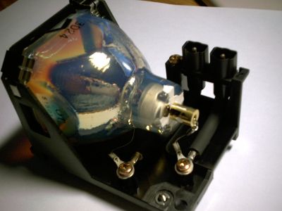

I finally bought a cheap commercialprojector, I couldn´t resist, the price was only what you pay for two 15" tft monitors. Well the UHP-lamp will last in 1500h and a the price for a new one is the same as for a new 15" tft. So of course I will not buy a new lamp-unit.
I found out that a UHP-bulb is actully the same as a HID short arc lamp, so the only diffrents between a HQI and a UHP is that the arc is smaller in the UHP, the light output is the same.
The UHP-lamp unit puts out a parallel beam that is 50mm wide. I think it´s not so difficult to build a HQI-light unit that puts out a parallel beam of that size. And because the light is parallel we can use a mirror so we can place the light-unit outside the pj-case.

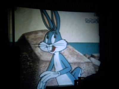

I did a very intressting comparision between the two choiches.
The pictures to the right are the diy-projector and to the left the commercialprojector. The pictures up is with the lights on, and down it´s off. The diy-projector, consisting of a 15" TFT and a 150W cdm-t bulb, and the new light engine with a PAR30-reflector. Because I use the PAR30 reflector it will be equal to a 7" -design.
The pictures are taken with the same camra, same dvd-player, same surrounding light and same screen-size 100". My camra don´t like dark pictures, so what seems dark is not so dark. Which would you choose ?

The reason the pro projector is brighter is a few reasons, 1 is a more refined light engine, 2 is because it has 3 lcds i beleive this gives us 3x the brightness as 3x 10% = 30% from source though i could be wrong on this and 4 maybe your optics are out, and 5 the lumens on pro projector bulbs are abit more then the cdm-t, not only that but you are not using a condenser in your setup and this will yeald u 2x the brightness atleast!. I think basically u cant compare a pro projector that has 3 lcd's to a diy projector that only has 1, the 3 lcd's do make a difference to the brightness, also if you wer to use the same lamp in both projectors then you would have a more acurate reading on weather the pro one is brighter then the diy projector, another reason the pro projector could be brighter in this case is the fact that lighting a 15inch area is spreading more light then in a pro one thats got its light fully condensed into a beam, trust me this makes a very big as i have tried it and use that kind of system in mine projectors hence a reason why i use small lcd's.

True I´m not using a condensor, because you can´t do that with a PAR-design the light is already condensed in the par reflector and it will never work with a condensor in a PAR-refector.
And Yes "lighting a 15inch area is spreading more light" but as you can see on the picture down to the left, I´m using a 10 degrees PAR30 reflector that lighting up the same area as a 7" tft screen, so if you magnifi that picture it will be the same as a 7"-design.
And no a pro-lamp is not brighter than a HQI, the pro-lamp is only 130W compared to a 150W HQI.
Why I bring this up is because the two choices actully cost the same, so is it really worth the money to build a 7"-diy projector ?

Yes I know that they use condensers in stagelight, but the reason they do that is to get the light more even and as you can see on my pictures the screen is a little darker in the corners, and that will be better with condensers, but the brightness will be the same as before.
And I´m pretty sure that the Pro projector will be much brighter than the 7"-diy projector even with a cdm-t bulb.

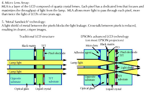

3 panel against 1.
Pro has microlenses, not avalible on a diy, give 2 times brightness.

Below is a explaning what microlenses are, and why they make the projector brighter, the picture belongs to EPSON.
