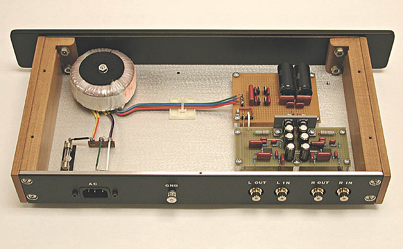

Hello to all!
I have been reading the posts about low cost phono preamps,
and thought that it might be interesting to post a picture of my
variation on the El Cheapo phono preamp. It is a variation with
MM only, and uses regulated AC power supplies (I like very long
warm-ups for listening). It has the following features:
1. 4.2 Amp toroidal transformer
2. rectification bridge with Harris superfast/soft recovery diodes
with capacitor snubbers
3. 4700 uF Panasonic HFQ electrolytics with 2.2/.01 bypasses
4. JRC +/- 12 VDC regulators (1.5A) with very low noise levels
5. bleeder resistors on regulator outputs to bias regulators
to a higher current output level
6. 3 paralleled Black Gate 100uF electrolytics on regulator
outputs, plus poly bypasses at chip pins
7. Class A output bias on OPA 637 units
8. outputs are direct coupled to RCA jacks (no problems here)
9. all circuit board connections hard-wired point to point
10. seperated ground returns where possible
11. all aluminum case with hardwood end panels
I spent just $ 115.00 (with help from my junk box) to build this
preamp. Even though the transformer is just 6.5" from the
active circuit board, the hum level is inauduible from my own
listening position (I have a subwoofer) at -73dB relative to
a 0dB level on a vinyl record. I broke in the piece for 300 hours
and did 2-3 day warmups for listening. In my opinion, the sound
quality from this design (even without the battery power supply)
is simply stunning for the money. Very fine transparancy, sound
staging, resolution, and a fairly neutral overall sound that does
not at all seem very "solid state". Perhaps just a bit dark in
nature. I have listened to preamps costing much, much more
that did not do as well. Many thanks to Thorsten for his RIAA
network design for this circuit!

VERY nice!
I like the inset jacks on the rear panel. Nice touch.
Did you do the mechanical work and lettering yourself? Looks like a pro did it?
Any hum at all (audible or measured with scope, etc.) with that transformer in the box?
Good job!

To All:
The case for this preamp took more time than building the
active circuitry. The front and rear panels are milled from 1/4"
aluminum that were sandblasted & painted. I also did hand
lettering with white Press Type Letters, and overcoated the
panels with Krylon matt spray for protection. the hardwood
end panels are indeed 1 piece millings. This case took so
much time that I may never do this again!
As to the transformer inside the case, there is a residual hum
that is about 73 dB below what would be considered a 0 dB
level (about 4 mV signal @ 1 KHz) on a record. I suspect that having the transformer a bit farther away (mine was within 6.5") from the active circuit board would help with the 60 Hz hum, although I never heard any interference from it unless I was
up very close to my subwoofer.
I am curious if anyone has built this design and listened to it with a very high end turntable/cartridge combo to evaluate the sonics.

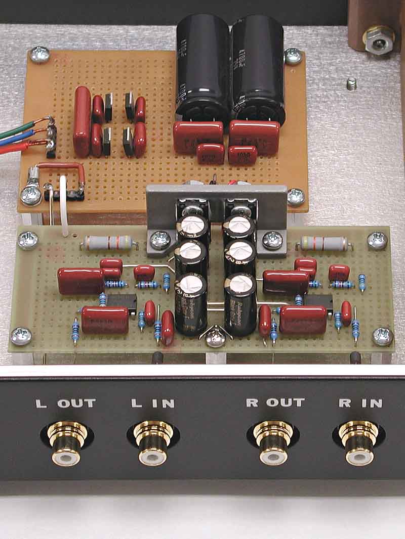

I have attached a detail shot of the circuitry.

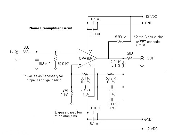

You are right in seeing changes between my
version and the "El Cheapo".
My version has NO output capacitors, since
the component after the preamp has them.
I was trying to eliminate as much circuitry as
possible for best sonics.
There have also been changes to the input
resistor configuration, although the final out-
come is still around 50K ohm input impedance
for a MM cartridge.
The RIAA network is still the same as the origonal
"El Cheapo", although I obviously went to an AC
derived supply, rather than the batteries.
Have you built an "El Cheapo"?
Fastcat

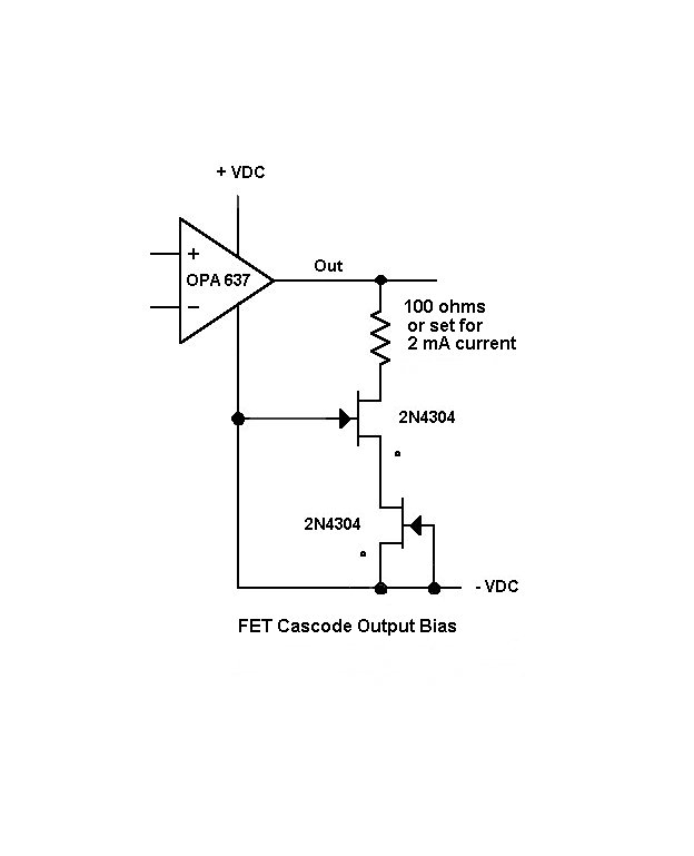

What about the cascode FET, any drawing?

To All:
I have attached a drawing for an FET class A
output bias for the OPA637 op-amp.
As to the plastic capacitors, they are all Panasonic
P-series poly 50V types with very low dissipation
factor and non-inductive construction.

fastcat95 said:
Hello!
I have attached the schematic to this post.
Fastcat
I am trying your schematic with P2P but I can not seem to get a good clean logical layout when soldering the parts on the bare pcb board. It seems the power supply wires will have to cross the small signal wires no matter which way I arranged the parts.
Do you mind sharing your actual layout / routing ?
