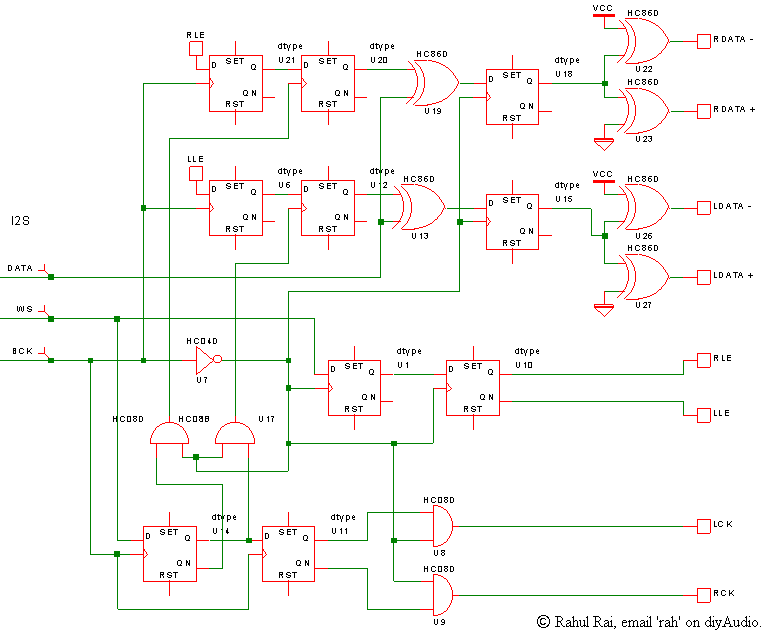

I2S to simultaneous mode converter with L/R differential split for TDA1541A
Hi Guys,
I was looking into doing the same thing, so that I can uses 2 * TDA1541A in a balanced configuration. A few weeks ago I had designed the circuit, but never got the chance to try it out (and I won’t for a while), but here it is, works in theory/simulation. I think it should be fine, but try it out and let me know. Comments, suggestions, questions, all welcome.
About the circuit
Well it’s not that hard to work out, it looks like it’ll take about 8 IC packages to implement, so not all that bad I guess… The top part of the circuit U19/20/21 convert the data from two’s complement to offset binary. U18, makes sure that the glitch produced by the logic that precede it, is not visible to external circuitry. The glitch is not a problem, as it occurs on the non-data-clocking edge of the clock (BCK). In fact it is possible to simplify the circuit if you let the glitch pass through, and this is ok if you’re going to feed the output straight into the TDA1541As. But this’ll get ugly if you’re re-clocking the data using a high-speed clock before feeding it into the DACs. So leave it as it is, there is no glitch.
The rest I’m sure you can work out, or just ask…
If you try it out, let me know how it goes… have fun 🙂

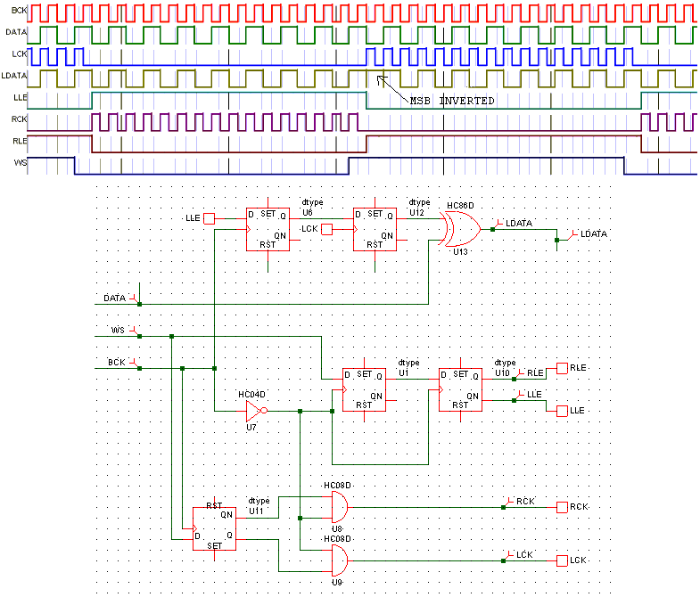

Was curious so I built it. Does not do what it is supposed to, though from its description, I must admit, I am not absolutely sure how it is supposed to do what it is supposed to do. What it does do very well is create a burst serial clock with a two cycle offset between them. No simultaneous data and no conversion to offset binary.
Unfortunately, I don’t have the time to work on it atm, as soon as I do, I’ll get into it and see what’s happening. Till then maybe someone else may wanna think about it. Here is a simplified circuit that I did (with the glitch), and the output waveforms, this is what I had simulated. The only difference between this one and the other one (above), is that the other one delays the data and clock bursts by one BCK cycle.
OOPS, and it should also be delaying RLE and LLE by one cycle! That’s probably why it’s not working, err…
The timings on this circuit are correct, and the relative timing of RLE, LLE, LCK, RCK, and LDATA / RDATA should be like this:

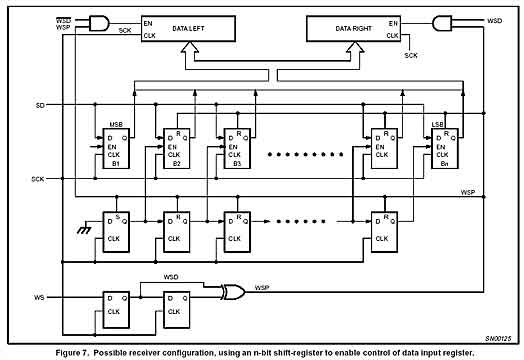

That circuit from I2SBUS.pdf can also be used to do this, ie. L+/L- and R+/R- output. There is another circuit in that datasheet, called the ‘transmitter’. If you make a ‘receiver’ and receive the I2S, you can feed the parallel RIGHT and LEFT data into 2 x Transmitters, which will pack in the data into 2 x I2S streams, which you can feed into 2 x TDA1541As.

Whatever mode the data arrives in, it is converted simultaneously. Serial data is loaded into the L and R data registers and both channels are converted on the first rising edge of bitclock after the falling edge of wordclock. So long as the L and R data registers are loaded before the conversion point the dac does not care and that is why the TDA1541A will work with bitclock frequencies of between 32Fs and 64Fs.
While not wishing to dissuade anyone from seeking to use the simultaneous mode, it has to be noted that it is a dead end in that it is only applicable to the TDA1541x. The L/L- and R/R- mode is far more useful in that it is applicable to a number of dac chips.

Did you try the second circuit ? Did you get those waveforms ? Checked that the TDA1541A was in simultaneous mode ? ( pin 27 connection) ? You must be getting something out, with all those signals going in? 🙂 or is it silent? 🙂

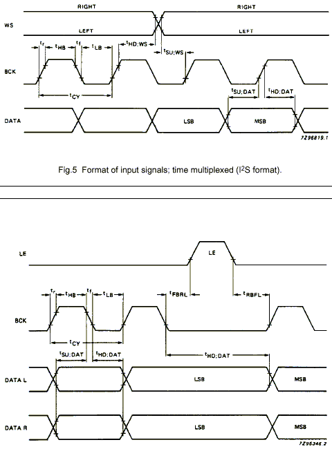

This is how it was meant to function, maybe someone can see the problem. From the TDA1541A datasheet:
“When input OB/TWC input is connected to VDD1 the two channels of data (L/R) are input simultaneously via DATA L and DATA R, accompanied with BCK and a latch-enable input (LE). With this mode selected the data must be in offset binary. "
If you look at the timing data below, you’ll see that LE goes high after the LSB has been clocked in, and loads the data from the shift register used to receive it internally. Now from I2S, we are able to select left/right data based on WS. So for example if WS is low, we select left, and feed I2S - BCK to LCK (the burst wave). With it goes the data. If the LCK clock isn’t ticking, it won’t load any data in, that’s why it remains low (after the falling clock-in edge), at this time the right one takes over. Now with I2S, WS changes before the LSB is clocked in (rising edge) , with the simultaneous mode we want the latch to open after the LSB has been clocked in (on the falling edge), so the WS signal is delayed appropriately.
The timing chart below shows that LE must close before the data for the next word is clocked in (starting with the MSB), and this is fine, cause the clock LCK/RCK don’t tick in the period where RLE /LLE is high (latch open) and no data is clocked in. Before the clock starts up again, LLE or RLE close, so that the data may be loaded.
As for the two’s complement to offset binary conversion, this can simply be done by inverting the MSB of each word. When WS on the I2S bus changes, the next rising edge of BCK is the LSB of the pervious word, and on the rising edge after that, is the MSB of the new word. We use WS and a few D-F/F to find the MSB, ie. a signal that goes high when the MSB of a word is present in the stream. And, pass the DATA and the find-MSB signal through a XOR gate. The XOR gate will invert the DATA when the find signal is high, therefore inverting the MSB, doing tow’s complement to offset binary conversion.
That was how it is suppose to work, any ideas ?
Wait a sec, I have one! 🙂
Does WS on I2S change exactly on the falling edge just before the rising edge which clocks in the LSB?
'rah' check the data sheet.... errr! NO. Carefully looking at it again T_HD;WS = 0 and T_SU;WS = 32ns !
If you can see where I've stuffed up, then try to fix it (it should be easy), my simulation I2S is wrong, WS doesn't change like that.
I'll post a fix later... err..
