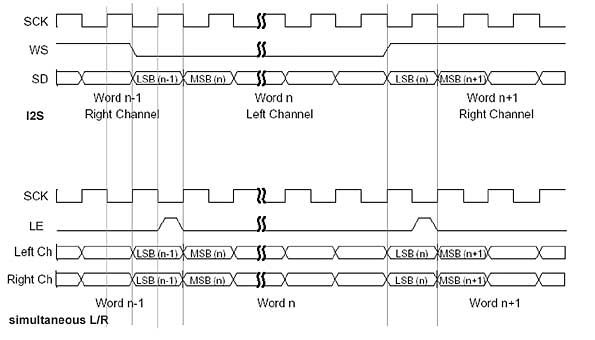

Rah
I done some "research" according to the
Philips datas of TDA1541A...
Putting together in a simbolic way the input fomats fraphs of I2S & simultaneously LR mode...
First I saw is that SCLK of the sim. mode is inverted (look at the MSB of words...)
and LE is still prior to the MSB...seems changing state only for the half of period of the SCLK...
Second and from the more importance is that looking at sim. mode bus implicates that dac go to conversion LR chanels literary simultaneously...
Third : I think that we have a good chance to use pair of DACs left bus goes to L & R of first DAC (out is Left un-balanced but parallel), and right goes to L & R of second DAC (out is Right un-balanced but parallel),
I did not get the answer about the
balanced output which bit or bit complement or ...I dont know is corresponds to +phase or -phase at the audio output of the dac...
please take a look at the diagram...

Zdravo Zorane,
I am trying to figure what is the goal here. To make the TDA1541A working in the simultaneous mode, for the sake of the knowledge & experience? To make two DAC chips unit, with each chip dedicated for one channel only, thus getting supposed benefits of going separate supply for each channel’s DAC? Or to make the DAC working in balanced mode? Or last two both?
If the balanced mode is still not what you intend to do (as you said in the post #12) and you want just a separate DAC chip for each channel thus you can use a separate supplies for them, why don’t you feed two DAC chips with the same I2S and tap the output for one channel from the one DAC chip and the other output from the other’s channel output of the other DAC chip? If you want to make each chip quiet for the anyway unused channel, I guess one HC157 and one inverter can accomplish this.
To go balanced (you still seem to be interested for this in the post #28) and maybe to get some other ideas, it is not bad to check this thread (if you did not do that already):
http://www.diyaudio.com/forums/showthread.php?s=&threadid=20867
Yes, according to the Philips’s drawing, in the simultaneous mode the data is latched on the trailing edge of the bit clock.
Seems like that but it might be also helpful if someone can point to the place where the simultaneous mode is explained better than in the Philips’s datasheet.
Yes, but from the practical point of view, DAC anyway do the conversion simultaneously, i.e. at one hand there is always some kind of buffering and at the other hand the output signal always appears at the outputs at the same time. The format of the incoming signal doesn’t change this.

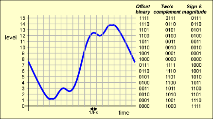

If you ask about the structure of the data, have a look here:
http://web.onetel.net.uk/~peterphmusic/pharri5833/digaudio.htm
(check the 4th figure)
If you ask about the way to get the inverted signal at the output, inverting of the data line of the two’s complement is probably the easiest way.

About the spliting phases or balancing...
I2S bus is a time multiplexed as well as
twos complement data format (see the picture )
TDA1541A in simultaneous L/R input mode expects data in off-set binary form...
Another thing : simple inversion of data bus throught inveter or throught reclocking flip-flops elements will give the uncorrect results even in I2S mode...
first becouse of fact that WS goes prior one clock cycle to the MSB and we always loosing the LSB of each word making the LSB of one chanel go to another...
As I see from the picture only the MSB of data word is important like information about phase...other bits are values of signal or magnitudes..?
please comment...

A counter to count the bits has to be added. It would have to stop after 16 bits so that the trailing bits don't flush out the first 16. I'll get working on it soon, if ya get it to work before then, let us know
Another thing, sorry for the slow replies (I've been busy). Unfortunately they'll be even slower now cause my DSL has gone down, and it's not comming back up for at least a week
(I'm using my work's network, by dial-up atm)
rah said:
Ray,
Yes, that was silly of me.. since my CDROM transport outputs 48Fs and the the CS8412 outputs 64Fs.
Rah,
Added the counters and it simulates correctly. Will try it with a real TDA 1541 and a FPGA later today but thats as far as I'll go. Started to convert from individual logic gates to 74 series packages but as the logic to create the 1:3 mark/space ratio signal alone looked like it would take 5 packages, I knocked it on the head. As I have a cmos/ttl board somewhere that alledgedly creates balanced I2S, I'll dig that out and see if it actually does anything.
ray.
