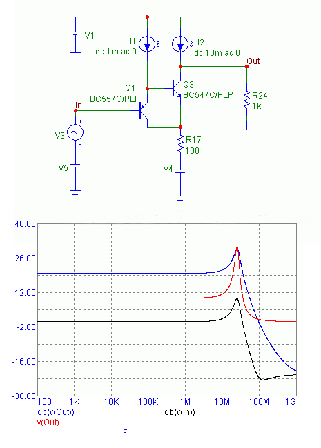

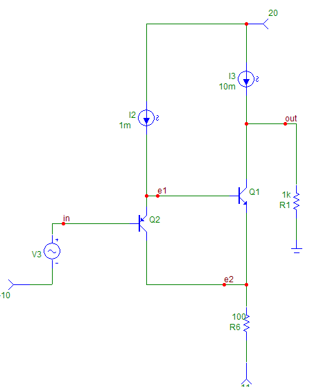

Hello,
I'm trying to use the Baxandall Super Pair, but everytime it will oscillate, in the simulator or on the bench.
As an emitter follower it's very stable (fixed collector voltage, CCS emitter load).
But if I try to use it with a varying collector voltage (typically in a VAS, low resistor emitter load, CCS collector load), I get oscillations.
Using the Super Pair as a Cascode also results in oscillations. Measured around 50-100 MHz on the scope.
Anyone has an idea on how to tame the beast ?
I've been playing with base stoppers to no avail... need help !
The attached circuit oscillates around 100 MHz.

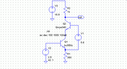

Hi Pierre,
Not really 100MHz per MicroCap and neglecting parasitic properties, but it seems like it doesn’t happen accidentally. Try the compensation capacitor (from the base of the first to the collector of the second transistor), say 68pF.
Pedja

Okay, I played around with this a little more in simulation. I think my earlier emitter resistor mod was some kind of fluke. It doesn't seem to help this circuit. Using a circuit similar to yours in the simulator (shown below), I got 31 dB of peaking in the voltage gain at around 53 MHz. An oscillator for sure. Then I started putting various values of series resistance into the base of the PNP transistor. I was quite surprised at how large this resistor had to be. With a series base resistor of 1k, I still get peaking, about 5 dB at 34 MHz. This is probably enough to kill the oscillation. It make me nervous though. Even with values as large as 10k, I still get some peaking.

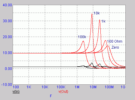

JCX’s explanation seems right to me, and as it can be seen I showed already what is happening at the input. But, if the non-zero source impedance is the cause of the problem, is it really the added impedance here the way to go? I see that there is a critical range of the impedance, but as Andy pointed out, you should probably have very high base stopper value to tame the thing this way and thus the other things would come into the consideration. In the graph I posted above the source impedance is 1k and yes, the peak shown by the small signal analysis changes its amplitude and freq as the source impedance changes (graph below).
Btw, even if used like the emitter follower, “super pair” shows more problems with capacitive loads than any voltage follower without global (classic) f/b that I simulated.

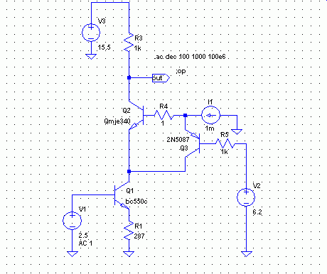

I tried a couple more things. I set up a simulation similar to the circuit I showed in Post #5 above, except using the circuit peufeu codenamed "funky" in the "amplifier topology subjective effects" thread here http://www.diyaudio.com/forums/showthread.php?postid=286698#post286698. The "funky" circuit also shows peaking in the frequency response in the 50-100 MHz range. Then I tried a different transistor for Q14 in the diagram of that earlier post, and varied its beta to vary the amount of compensating current fed back to the emitter of the main common base amp. With very large beta in the "sensing" transistor, the compensating current is almost zero and the peaking goes away. But when the transistors are nearly identical for beta, the peaking in the response again comes back.
So I thought, "what if the very act of feeding the base current back to the emitter is what's causing the instability?". This seems possible, since two circuits that use this technique (super pair and "funky") have the same problem. But there's another - the Hawksford cascode. I've shown the circuit below. How does it do?
This circuit has 34 dB of peaking at 57 MHz. The conclusion I'm reaching from all of this is quite unfortunate: Circuits which attempt to compensate the base current, such as the Hawksford cascode, the Baxandall super pair, and the "funky" circuit suck for high-frequency stability. Depressing.

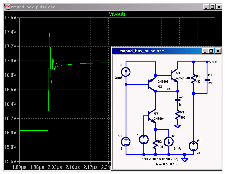

while i still would go for a thorough mathematical analysis before selling anything using this, i think i've found a correlation that makes sense - the input Q should be similar or slower speed than the output Q which explains my satisfaction with the circuit and the difficulties seen using it with higher V, slower devices in a power amp VAS
a possible approach below tames the worst case combination of andy's slow mje340 with the fast 2n3906 - i haven't looked at how much it compromizes performance
(i only kinda trust transient analysis in spice, .AC not at all, it can go wrong many ways)
(this is using trapazoidal in LT SwCadIII)
play with C2, R3 values; 500pF, 30 Ohms gives very good pulse

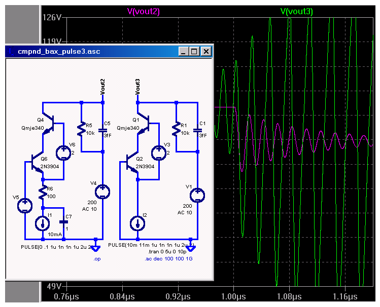

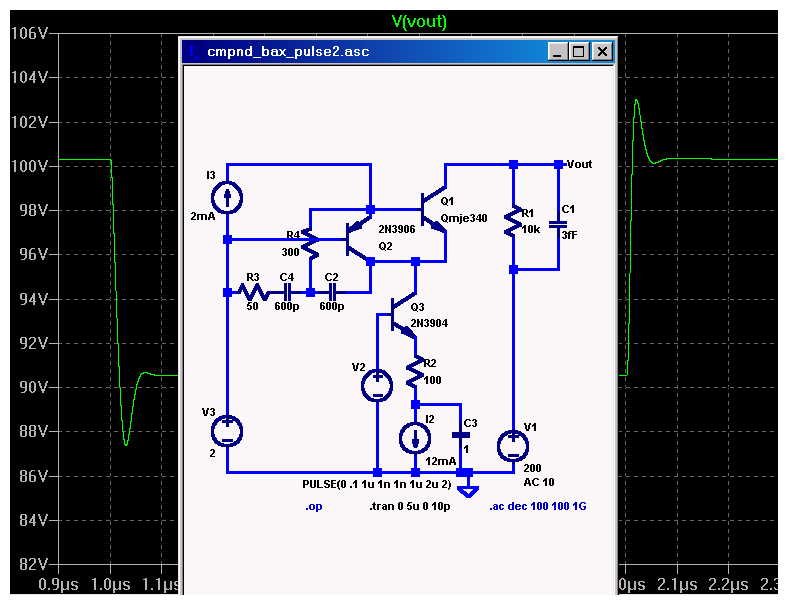

this seem to work, i think it can be considered a RC "stopper" across the input Q2_cb; at high frequencies the RC shorts out the gain of Q2
this is equivalent to my first schematic with the loop minimized by going directly across Q2_cb instead of including V3 cascode voltage source which would introduce parasitics at 100 MHz in the real world
to regain more audio frequency performance i split the C and bootstrapped the midpoint to Q2_e, this gives the expected 40+ dB improvement of output Z over the simple cascode with the mje140 up to 40 KHz, and 20 dB better performance to beyond 1 MHz; the R3, C2,4 chain must have very low parasitics at 100 MHz, NPO surface mount would be best
(i also fixed the output current, its now 10 mA as i intended – it was only ~3mA in my earlier schem)

JCX,
Try these mods, Q3 should have a base stopper, insert R between Q2 collector and Q3 collector, insert R between Q1 emitter and Q3 collector. Remove the compensation network.
Terry
