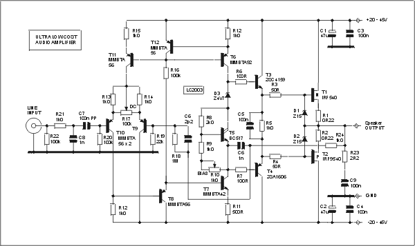

Ultra Low Cost Amplifier design, here is my first proposal...
Power is 50W in 8 Ohms, 100W in 4 Ohms, 5 - 100.000 Hz.
It is a fairly conventional amplification stage, followed by a industrial MOSFET output (extremely rugged). It can be tweaked and scaled to larger output power with ease....
The values around T5 may have to be experimented with a little.
It should build for less than 10$ including a PCB. (Which i will not be making or selling .. anyone else can do that if they want).
I encourage anyone with ideas for ultra low cost amplifiers to post them here, and let's discuss some solutions.
You can see an enhanced image here: www.lcaudio.dk/ulcamp1.gif
All the best from Lars Clausen

Lars,
Great idea to buffer the gain stage from the differential, but I think it would better to lower the value of the buffer resistor and attach it to ground, also use a current diode to bias the current sources. Just some thoughts.😉

Interestng, some questions though: Why have you so high-ohmish feedback?
Why do you choose to have so little gain in the input stage? Isn't it a little bit better to have lower emitter resistance values?
Isn't it smarter to have a mosfet like BS170 for bias? I know that bias circuitry can be tricky but this was just a thought. With a BJT you can get too much mV/degC. I see that you have a zener also so maybe this is enough.
T8 is connected very unusual, never seen before but looks smart from distortion point of view.
How necessary are R1 and R2 in a single pair configuration?

jam: Thanks for your suggestions, i will try to find a current diode at a low price.

Peranders: The high ohmish feedback is to partly balance the high input impedance 100k, and that one is intended to keep down the value of the 100nF cap in series with the input.
So it is still cheap to get a good quality cap.
High emitter values in the input stage is to keep open loop gain low ( = good sound ).
BIAS circuit, you are right, this stage may require a little fine adjustment, maybe some changes can also improve the design.
R1 and R2 may be unnessescary, depending on how good a thermal coupling you can make. I included them just to be extra sure it will work every time.

The VBE of T12 (0,65V) limits the voltage over R12, which comes from the current drawn on the collector of T6. If the IC of T6 attempts to go up, the Voltage over R12 goes up, and with it VBE of T12. This subsequently tells T12 to draw more current (away from) the IB of T6, so it's IC falls back down.
On B of T6 you will end up having a temperature compensated voltage with respect to +45V, so the same VB is reused to fuel B of T11. T11 will now track the current drawn by T6, thermally balancing the whole circuit.
This setup is actually a classic amplifier used by a great deal of amplifiers from the late 1980's and 1990's. I have added a few features to it, the buffered Gain Stage, and also a frequency split feedback circuit, so high frequencies are fed back from a short path, (with low time delay) while the lower frequencies where a higher damping factor is eesential, is drawn from the output.
This makes the amplifier better sounding, and more stable to capacitive loads, for the cost of just 2 cheap components.
The latter method can be adapted to work in almost any conventional amplifier circuit. And have the same beneficial effects.

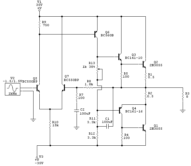

I was planning to submit my own circuit, but it actually is a circuit of Rod Elliot: a version of 'El Cheapo'.. much like:
link: http://sound.westhost.com/project12.htm go to figure 1
but then with a Long-tailed input.
How about that for a cheap amp?
Thijs
I'll make a drawring.....

I think this should be our barebone, low-cost, no features but still good functional amplifier to start from... features as MOSFET outputstage, BTJ-bias, buffered Diff-pair etc etc can be added.. but this is it... as sinmple and low-cost but still functional as can get..
