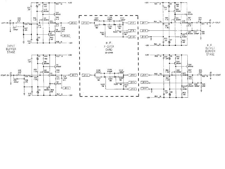

Here is an obsolete commercial offering that used plug in boards (no longer available).
This design is fairly unique in that it has a full descrete bi polar input buffer and output buffer for the hi pass section.
The hi pass section uses all descrete active stages and the low pass uses the LM 833 chip. The high pass plug in board has all the passive filter parts , while the low pass boards have the chip and passive parts. (pity know one has any boards for these units, they were designed for the JBL XLP-200, and apparently DTS bought up all the remaining stock of DX-1 crossovers after the XLP -200 was discontinued).
Ian
Ian
Everything is pretty much explained in XVR manual http://www.passlabs.com/pdf/XVR1MAN1.PDF
Even the schematics are given out (check pages 30 and 31)

So, it depends on whether you want to experiment on the fly, and from reading Mr Pass XRR1 Crossover Bible (which is surely the most comprehensive manual on crossovers this side of the black stump), this is a must do if your a audio Nut like the rest of Us.
Imho, I see no reason not to use the Sallen-Key passage and then an inverting buffer as Mr Pass has used here (and also in the Ono) . It certainly rationalises the guts of the crossover, the inverting -ve signal does not stand in the way of the original +ve feed.
Attached is an edited version of the block diagram of te XVR1 manual (for my own educational purposes only).
At least in pro audio (and the Aleph Series improve performance), the aim of Balanced signal input and outputs is really for best CMRR i.e. less noise and distortion, in other words eliminate the lousy earth loops that make bi amping in unbalanced a crime. It is only required at the in and outputs, not the processing.
So for bi/tri and quad amping balanced operation for the inputs and outputs is a given just to keep the hum out of the picture
I recall the multiple feedback stuff is widely used in state variable filters with multiple high order slopes (like Rane Audio's AC22)

I see where you are coming from, perhaps you can arrange an X*X crossover, that would cause a twinkle in the eye of the diy Egg Heads.
But surely the complexity or flexibility of a active crossover lies in its ability to mimic the passive version of a pre existing system which more oftern than not is tailored for a flat response and discerning listening tests.
For example, at the moment I'm tackling a speaker building project end to end, its a proven pre engineered design from a local USA icon JBL (the 4345 vintage model) so I already have the hard numbers done for me and graphs and the like.
However, the active mode requires a tailored crossover function at 300 hz to match the existing passive crossover which was engineered to account for mutual coupling of the woofer and midrange drivers.
I reckon this is where the real virtues of active filters are. Of course if you are starting from scratch with drivers and all sorts from Parts Express then that's a whole different ball game. A measure system at least as good as Winairr is required to see which ways up and who's who.
Otherwise its the blind leading the blind and no amount of elaborate filtering will help find the right result efficiently, unless you are prepared to age gracefully by trial and error.
