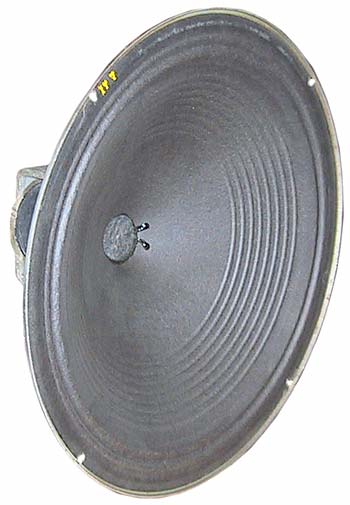

OK......Here's what I have noticed wearing out in all of the loudspeakers I have repaired:
1) This is the most obvious one. Foam surrounds will rot out whether they are heavily used or just sitting in your grandmother's attic. the materials used to make the foam surrounds just break down over time. There's nothing we can do about it. Oh well, time for a recone.
2) Cone fatigue. This usually only occurs in professional loudspeakers that are being driven very heavily night after night in club PA systems where the DJ thinks that the red clip lights actually make it sound better. I can't complain though, it's job security for me.
Cone fatigue also shows up in speakers that have spent their life in the family room with a bay window. The UV light from sunlight will degrade the paper in the cone, reducing the cone stiffness. When this happens, cone breakup begins to happen at lower and lower frequencies. Also, the user will start turning up the speakers louder and louder to get the sound they are used to. If the cone is degraded too much, it will actually tear right through about a third of the way up the cone. I don't see this often, but it does happen.
3) In loudspeakers that see a lot of heavy use, the voice coil can actually start to wear out. The color of the insulation on the VC wire begins to darken, and the insulator can melt, causing a short in the VC.
4) I have seen the paper surrounds in very early JBL D series speakers crack. The cracking actually occurs perpendiculer to the surround. Or, from the inside to the outside. Usually, a little bit of black dome glue can seal these cracks but once the damage is done, the speaker will always be damaged.
5) Every now and then, I will see the glue fail between the cone and the surround. Usually when this happens, it is caused by a defective installation and should be warrantied by the service center that did the original construction of the cone. I have never seen this on older speakers that have been in service for years.
6) A less obvious, but still important, thing that can happen is the loss of magnet efficiency. The AlNiCo magnets of the early years, and the newer Neodimium magnets can actually lose their power. AlNiCo V magnets naturally lose their magnetic fields over time wheather they are degraded by heat or not. This is one of the reasons that the '59 Gibson Les Paul sounds so good. They used the AlNiCo V magnets. Now, 40 years later, the magnets have lost some power, and the pickups are a little softer and snoother sounding. This, thankfully can be fixed. There are several places around the US, and I'm sure there are plenty in the rest of the world, that can re-magnatize your vintage speakers. Orange County Speakers comes to mind here. As far as the newer Neodimium magnets, just don't over-power these. Please!!!!! When these magnets get heat stressed by someone overpowering the speaker, they lose thier magnetic field. I can't think of anywhere that can remagnetize these speakers. I've asked Orange County if they can do it, and the answer was a big, firm NO.
7) The whole suspension system can wear out. This basically means that the restorative forces in the speaker lose their effectiveness as a spring. Any spring be it metal, paper, rubber, etc. will eventually lose it's elasticity over time. If it is only the surround that has worn out, this can usually be replaced. If the spider is worn out, it's usually a good idea to re-cone the whole speaker. As spiders usually take quite some time to wear out, chances are that the cone and surround are also worn out and should be replaced.
If you are worried about your speakers wearing out within a few years because your family is cranking the stereo, I wouldn't worry too much about it. As long as you are not clipping the inputs of your amplifier, and you are not bottoming out your voice coils, your speakers should last for decades. I would only worry if you get your giant 5000W home stereo amp built Circlotron.😉
