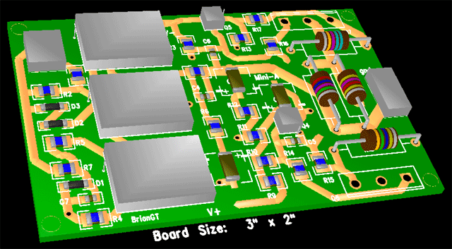

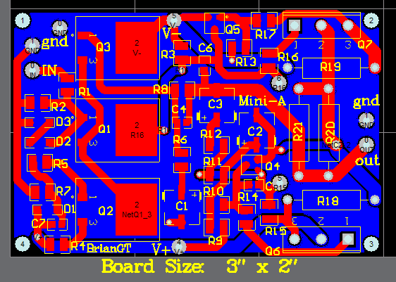

I decided to take a try at making my own Mini-A layout. I decided to use equivilant surface mount parts for all except for the output resistors and output devices. It is pretty much Grey's original schematic, with a couple of additions suggested in the thread.
Here is the schematic.
I should be getting a pair of boards made in a couple of weeks for testing.
As for the parts, the caps will be panasonic PPS film, and Panasonic FK electrolytics (lower impedence version of the FC).
I started a small stereo chassis for these things today as well 🙂

As for a fun exercise, grab a ruler, and zoom the picture with an image editing program until the size is exactly 2" tall (there are grid lines signifying inches), and this will be the exact size of the board.
I should have boards in a couple of weeks, and if they work out well, and people are interested, I might organize a group order, or provide the layout files to someone who would want to (not-for-profit).

If you are trying to make this as small as possible, you could save a LOT of space by replacing Q1 and Q3 with 2sj109 and mounting Q2 vertically. Mounting R18-21 vertically will save space and probably reduce thermal noise by allowing the resistors to reject heat more efficiently.
Many parts are more compact in their through-hole body than in an SMD. A vertical TO-220 transistor will take up less room than a horizontally surface-mounted one, and Zetex's E-Line package uses less board space than most SMD transistor packages. Electrolytic caps are also more compact in through-hole packages.
Of course, if compactness is not your goal, you should kindly ignore me.

Actually, the idea behind this board was to make it small, and use SMD parts. I don't like the idea of putting resistors vertically, because it puts a lot more strain on the pcb contacts. I have a similar opinion about putting the input fets vertically. I also like the idea of the board being lower profile, as it will allow for a smaller chassis.
As for the capacitors, the new Panasonic FK capacitors are lower impedence and smaller then the through hole FC ones.
Brian

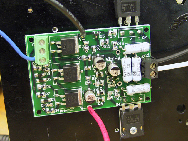

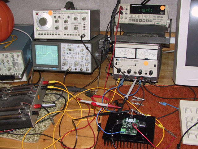

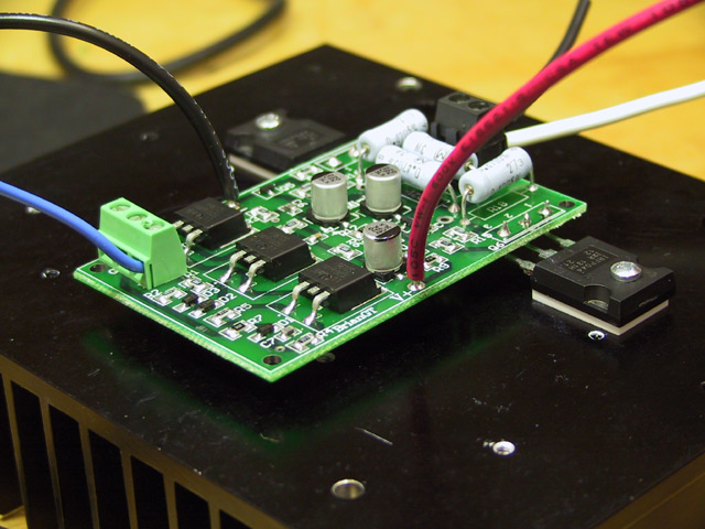

Well... I finally got around to making some pcbs for this Mini-A board, and I decided to populate them last night. It is working pretty good so far.
Here is the board mounted to a heatsink for testing:
Brian
Here is an overhead shot of the layout. It wasn't that hard to solder. I did have a mistake when I was testing it..... I hooked only the positive 15v up to the amplifier, and cranked up the voltage. It managed to kill the BJT in the CCS, but with a simple replacement, the amplifier was up and running on a bench supply, drawing 1A of current off of a dual 15v supply setup.
