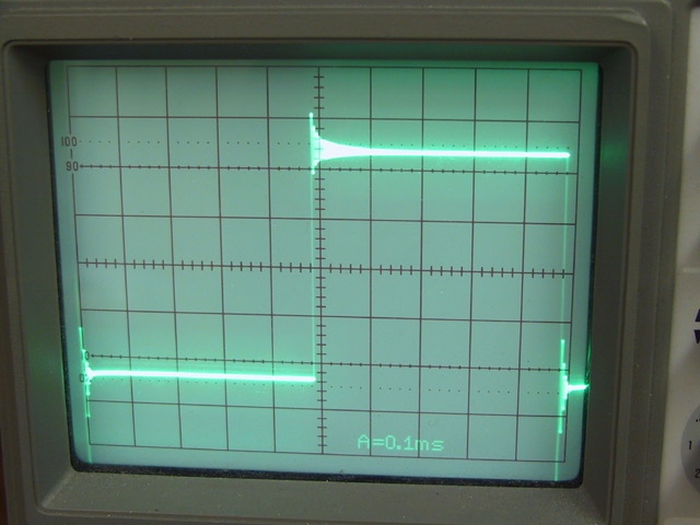

Here is the sine wave response that I got at 1khz.. looks pretty normal. The clipping (not shown), was nice and symmetrical.
Brian

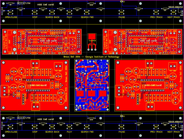

I have already gotten a couple of requests for pcbs :D
I only made a couple of boards for this, stuffing the layout on some spare space on my CD-PRO2 prototype boards.
If there is enough interest, I do a board run. I didn't feel that enough people would want to do SMD boards, since it requires more patience to solder the boards, and there is less choice for exotic components.
Also, I can provide the gerber files if anyone wants to get their own boards made, or do a group order (not-for-profit, non-commerical use only)
Here is a picture of the layout for the pcb that I got made. You can see the Mini-A in the middle (2"x3" size)
Brian
Brian,
Count me in for at least a half dozens sets of boards! Thats a really nice clean layout. I finished my Mini a while back and it had similar ringing. Try a .047 or thereabouts across the MPSA18 in the constant current source. That tok care of 95% of the ringing in mine...now just a slight overshoot. I'd be curious to hear from Nelson or Grey about what causes this ringing and overshoot. Its not audible as I couldn't hear any difference with or without the .047 in there. Miine is running both channels from a single 320 VA tranny at plus and minus 16 volts DC using a single 120,000 mfd Panasonic cap per rail.

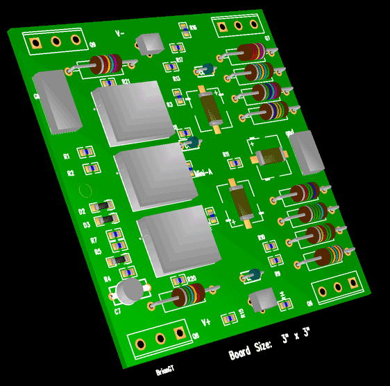

Forte said:
If you do so,
I am also considering running a 2 pairs of parallel output devices instead
it will not an "mini-A"
should be an "small-A"
:D
4 devices essentially makes it an Aleph 5 - 30w amplifier...
(3d rendering from the board layout software)
Brian
