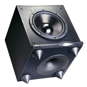

Polk uses what appears to be something like that for a built-in powered subwoofer. They add a pyramid thingy with curved sides that points up at the port and call it a "Power Port (tm)."
http://www.polkaudio.com/home/technology/pwrport.php?category=3&speaker=164
It's not adjustable though.

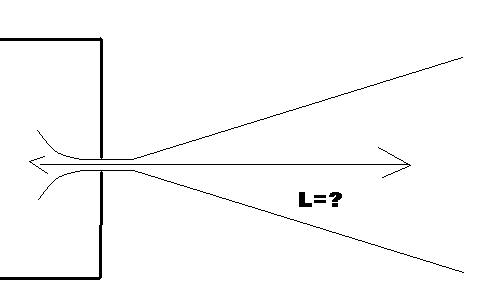

The idea seems good for another reason than adjustability (see schematic)
The box act like a big flare, just when the air exit the port, there is a limited area to pass which is the circumference of the port multiplied by the height of the gap (point A). But after a while (point B) the air have more space so the speed goes down, like in a flare.

I believe slot ports are calculated like any other but use a bit different end correction factor and the effective length is measured down the physical middle of the duct, no matter how it's folded.
But I don't think this setup would behave like a normal slot port. Wouldn't the top of the cabinet you place this on act like a wall of the port, changing the effective length and tuning? I've no idea how you could predict the results.
It would be interesting to measure the output with the box upside down, compared to the normal orientation.
cheers
That's the problem I have. The cabinet will act like wall, making the port longer. But it's tough to evaluate precisely. Also, it's like having a big flare after the port, like the in drawing I attached, what is the effective lenght of that port??
That's why I will tune it by ear I think, by adjusting the gap between the speaker and the stand. I will make a slighly bigger port than necessary and reduce the effective area by adjusting the gap. I am now building my speakers (slowly) , I will post the results later.

Flaring a vent raises its tuning frequency for a given length due to the larger end correction, i.e. it 'feels' like it's bigger than it really is, so the effective length must be increased to maintain the same Fb.
IOW, let's say a 3" diameter x 10" long vent tunes a cab to 40Hz, but at a high vent mach so you add a homemade flare that's 1.5" deep, so as a R-O-T you don't shorten the 10" pipe, instead attaching it to the flare to make a vent that's physically 11.5" long.
If you want to calculate it a bit more accurately, find the new effective diameter to calculate the total length.
GM
