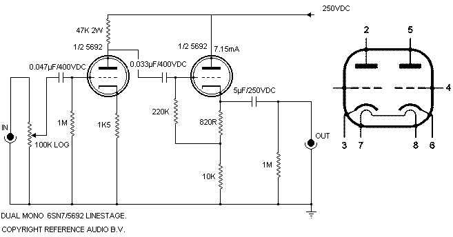

I have started work on another line amp in order to use up the 5692 red base tubes that are sitting on my bench. What I have drawn is mostly by memory(and that it fading). Would you mind taking a look at what I have got and suggest corrections and modifications please? Schematic is drawn in handicad.
I haven't done the PS yet. I do have several transformers. a 250-0-250, and a 370-0-370. I would like to incorporate several regulator tubes to achieve a B+ of 250V.

From what I see you left R7 and R9 undefined, correct?
C3 is 470µF?
C2 is 0.470µF which for most applications will likely be too small.
C1 however will be a little too big once R7 is defined...which is where you have trouble, I assume?

It has been brought to my attention that there is a similar schematic here in a post that uses a 12sn7 tube with a 300v B+ supply. I would like to use a similar schematic and adapt it to the 5692 tube only since it is more delicate that the 6SN7 is.
I would like a 250 volt B+ maximum I believe. I think that is the limit on the 5692 or close to it. I would like some help with the other values involved. As Frank was good to point out I have several missing R values and several C values that are incorrect.
Frank
I assume that R7 might be around 47K and C2 might be better at 1mfd. I think that R6 and R4 would have to be refigured also.
I will need to drive the 100K input of my Quicksilvers. I'm starting to believe what I was told months ago about not needing much gain.

Here's what I came up with this morning...
Let's hope I didn't make any mistakes:

Wouldn't pushing 7.15mA out of the tube be at the limits for this tube?
I don't have the electrical data for this tube that is why the question.

Max. cathode current is given at 15mA so that should be safe.
I'll e-mail the datasheet of the Red Octobers if the file isn't too big.

A rough guess would be about 8V/9V out for 1V in.
I deliberately didn't optimise it for gain since you'll be throwing it away most of the time anyway.
If you need more gain, decouple the first cathode R with a good quality cap and live with the colourations...

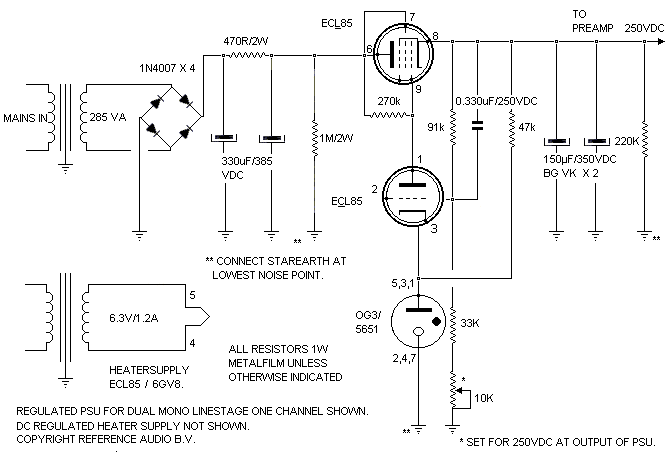

Do you need a PSU to go with it?

Hi Frank
Thanks for the help. With regard to gain... I have finally become a believer. Mega gain isn't needed in a line amp.
With respect to the power supply... I was going to use a 5Y3, a 370-0-370 transformer, 2) 50 mfd capacitors, 2) 30H chokes@ 40mA 595 ohm and a VR150 and VR90.
I would value your opinion on the usage of the above. I'm kinda stuck on the chokes and regulator tubes now. Its the same supply I am using on the 5687 line amp I have so I assume its beefy enough for the 5692's.

And you'll still have ample gain to burn...wich will give you lots of dynamics either way of the scale...
Use a tube rectifier if you like but with the advent of the Cree Sics diodes I tend to prefer those, money no object.
Granted the tube rectifier + choke may still win sonically but probably not economically. (Who cares?)
Provided you make this a dual mono PS, I'm confident it has everything to be a world-class pre.
You can still adopt chokes in the PS, I like them there; they make for good isolation between stages but here's the everyman's PS:
The P.S. can be redrawn for choke use, hey, you need to get rid of them 150H Hammonds, right? 🙂
