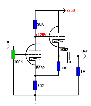

burnedfingers said:Don't tell me I paid $80.00 for a pair of 6SN7's with red bases.
OK.
Burned fingers, I certaily can't argue with your choices, despite offering a few alternatives.
So here is an afterthought. If the CCS shunt regulator would cause the pre-regulator portion of the to see a constant current, then the frequency dependent impedance of the PS is eliminated from consideration.
So, my guess is that if you simply designed a constant current draw configuration (my second solution), you would achieve the same effect without regulation.
However, you would lose isolation from line variations as Frank reminded me.
I have yet to hear the kind of difference that you have heard, so I will believe them until I have this opportunity.
Have you paid a visit to Frank's tube pages to get info on the 5692? If you haven't, you may or may not want to go look.

Hmmm. The RCA Red Base 5692s I have here have noticeably thicker glass and a MUCH sturdier plate/insulator/support structure than any 6SN7 I've seen.

burnedfingers said:Quote)
Many audio DIYers don't like capactors and avoid them at all costs. I know that this topic has been endlessly discussed.
On the other hand, the small amount of grid current that will flow through the volume pot can damage the materials as the wiper travels over the resistor.
You have brought up some very good points here. I feel I should tread toward the safe side and go with the additional cap or two. I occasionally use my project line amps with SS gear to have friends audition the sonic benefits of the tube gear. All have been impressed. I don't really want to chance the stray event of DC's possible damage to SS gear.
Quote)
I am less convinced of the need for the regulated supply for this amp, but I understand some the reasons given (and I know that Frank and Brett have a better feel for this). My guess is that you might be wanting to keep this project in some kind of budget. If so, I think that a CLCRC PS would be good enough to build first.
At first I didn't see the need for regulated supplies and reguarded them as tweeks. I became a believer after playing with the VR tubes and auditioning a line amp that was the same circuit as mine only featured a regulated supply. The result is unbelieveable and needs to be experienced by all. The cost in a minimal factor in my projects.
I will try this with Frank's regulated supply and Frank's Schookky's and drop the tube regulator idea.

Most CD players, except for perhaps the more esoteric ones have a cap on their output so I would say that the chance of damage to the pot from stray DC is small. On the other hand if you are going to regulate the supply and build it to the hilt do it right and put in a stepped attenuator and you won't have any worries. As far as regulation goes I have avoided it to this day simply because I have a nasty perfectionist tilt to my psyche and if it changes the sound to the better as drastically as you say then I would no longer be able to build simple circuits with resistors, capacitors, chokes and transformers and be satisfied with the sound. Then the powerful appeal of something so simple, so out of date, that sounds so nice (overstated warmth, distortion and power sags and all) would cease to be such an interesting and rewarding enterprise and would turn into a full blown obsession for the absolute perfect measurements and the most pure signal that I could afford to achieve. That as opposed to the semi-obsessed state I have been in since I tasted sweet success with my first project. Were I to go down that road of personal torture and discontent, were I to venture into that complex and arcane world of formulas and intuition (black magic?), I would soon be divorced and lonely and generally a waste of good oxygen. I'll stick with the romance and ignorant bliss. Perfectionism is the road to madness for me personally......sigh. I would build a nice CLCL filter with good stiff caps of the best quality I could afford and enjoy the fruits of my labor. Of course if you are already on the audio insanity search for the ultimate sound and technical perfection then you are on your own. Contentment is priceless and willful and selectively maintained ignorance is the key to a happy life.
