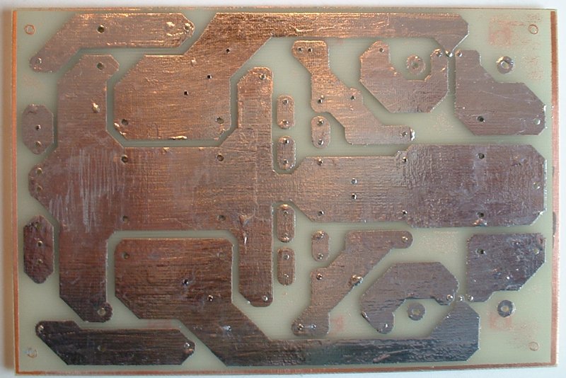

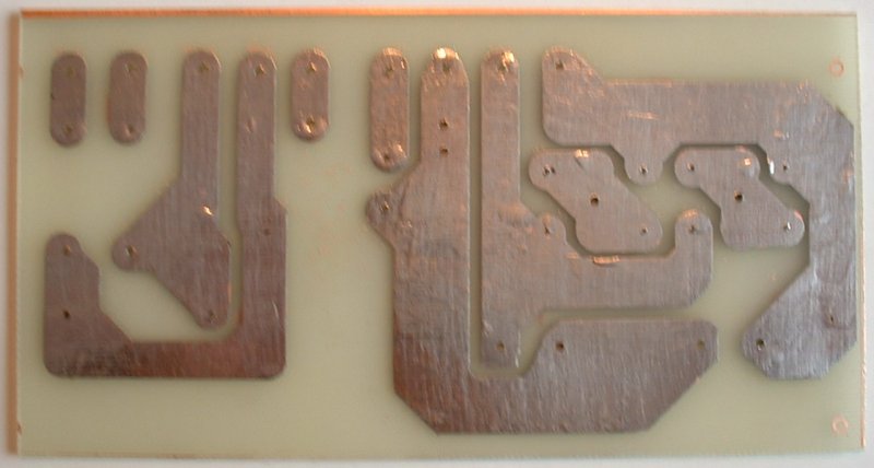

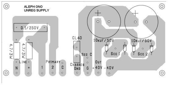

I had to pratice my pcb skill and decided to build an ONO phono preamp following the fantastic help I had from Ed Robinson. Ed sent me all his pcb and schematics and also in unvalueable building notes and great parts list. It was so easy to build from them that I went away and order the parts. 😎
See this thread for Ted impressive ONO: http://www.diyaudio.com/forums/showthread.php?s=&threadid=13201 😎 😱

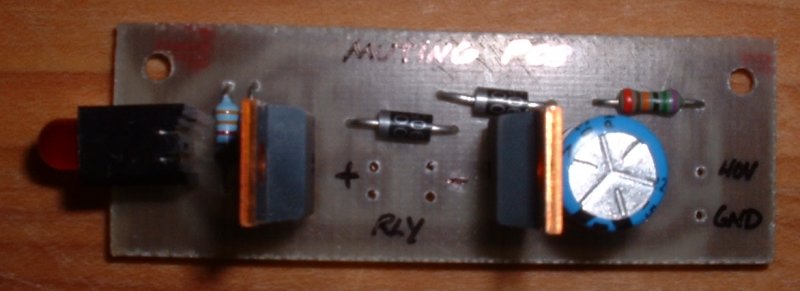

I already built the two Unreg 40V supply PCB and the two Regulated 30V supply PCB. I made some minor change to Ed PCB by increasing cooper area. See my next post
Thanks to Ed for all his work that he was kind enough to share with me. Thanks to Mr. Pass for sharing his great desings.

glad to see that you picked up ed's layout and willing to develop it , i wanted to do the same but actually iam overloaded with work it would be great to see your completed ono🙂
Really nice pcb but althose vias...without solderd through holes... (especially underneath capacitors...its gonna be a pest to solder that board (IMHO) but still really nice looking!

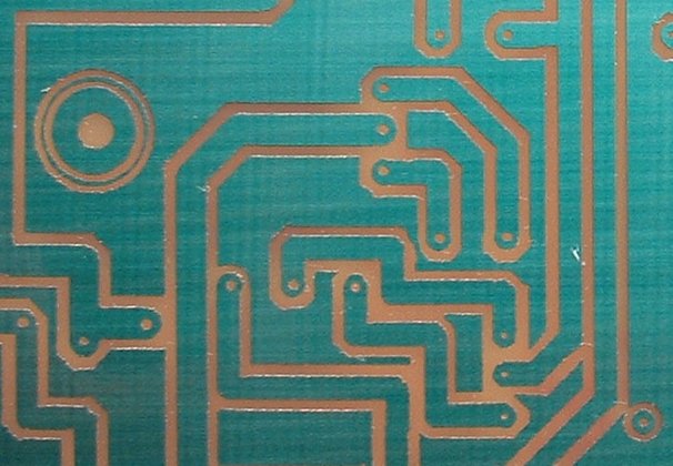

My Via Technic
I got my own technic to do via. I'm doing the connection between both sides using a very small piece of wire-wrap wire (AWG 30) that I solder first on the traces close to the pad. Then I solder the part.
This is not my own pcb desing. When I do a pcb that need via, I always put a second pad outside the part to do the interside connection. This way, I can use a normal piece of wire to connect the two pads. Thanks for your comment.

Nice work
Very nice boards. You'll have to share materials and methods.
Vias (in the orginal) were fairly easily done using copper flange pins.
These were soldered in before the components, and not placed under capacitors for the obvious reasons.
Your method sounds even simpler.

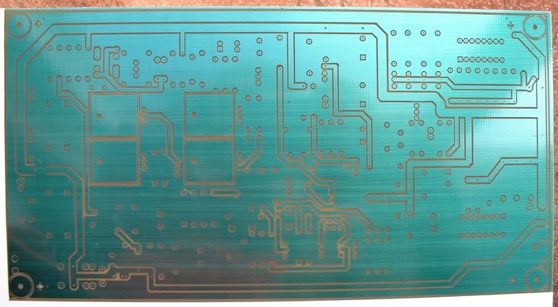

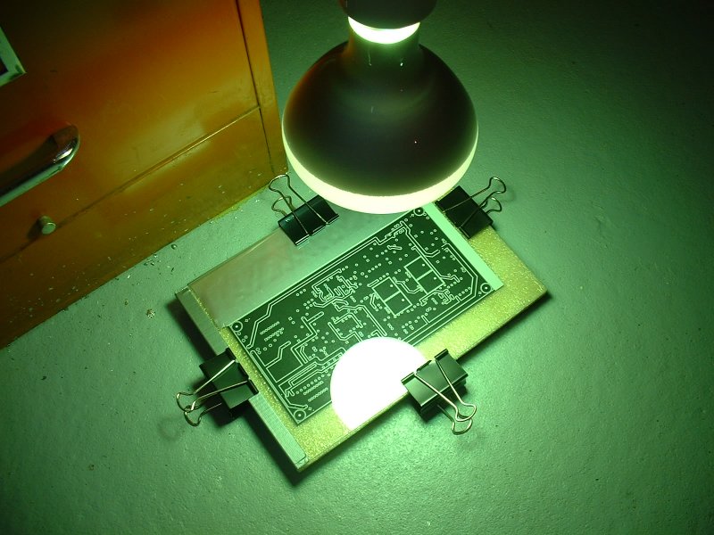

PCB Method, the exposition
1) Print the Artwork on a transparency using a good laser printer. Here you need a dark very dark. I used a new cartridge, then I printed 2 TIMES )
the same image over istself. That gave me a very deep dark. The process that I used need the POSITIVE image. Cut the transparency to about 1/2 inch bigger than the PCB dimensions. Using a soft tip marker, indicate what side is the TOP to expose.
IMPORTANT:
Do all these steps with a small section of pcb to practice the correct exposition time with your light source and to find the correct developper concentration. Then once all set proceed with the real pcb.
For a two sides PCB, the top is printed normal, the bottom need to be the mirror image. Your also need alignment cross on the pcb to align both sides images, see next step.
2) Put the top image on the cooper clad board with its protective sheet still in place. Using something sharp mark the PCB dimensions and the alignment cross centers.
3) Using a Dremel drill and a very small drill bit, drill the alignment cross center.
Do the next steps inside at medium to low light condition.
4) Using a knive and a ruler, cut the protective sheet and remove it.
5) Installed on the exposition table, put the top image on the board. Use the alignment holes to position the image perfectly. BE SURE TO ORIENTATE the image correctly. Close the window of the exposition table and clamp it firmly. See my own table here...
6) Using the lamp that I had, I exposed for 8 minutes. Time using a stop watch.
For a 2 sides PCB you need to expose the other side...
7) Open the exposition table. Remove the top image from the copper clad. Flip the PCB. Put the mirror bottom image on the board. RESPECT the orientation of the image. Repeat steps 2 to 6.
Now you have a cooper clad exposed on both sides.
Total time with a little pratice, around 1/2 hour.

PCB Method, Development
Put the exposed cooper clad in the correctly diluted developper bath for 30 to 60 sec. The developper remove the coating where exposed and you see nice cooper. Rinse with tap water. Let it dry for 2 hours. This step is very important. Take a beer in the mean time... 😉 or exposed the next PCB 🙁
TEST THE CORRECT CONCENTRATION with a small piece of pratice pcb before developping the real pcb.

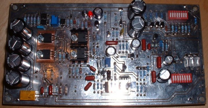

PCB Method. The last steps
Drill the holes using the correct drill bits. PROTECT your eyes and maybe fingers 😎
Protect the copper. I use liquid flux that I put everywhere, then I put solder on every traces and pad. I don't recommend using liquid tin. It is harder to solder after using this solution.
Install the via if using a two sides PCB.
You're done. I did my two ONO pcb's (without the drilling and the tinning) in an evening while listening to a movie with the familly.
