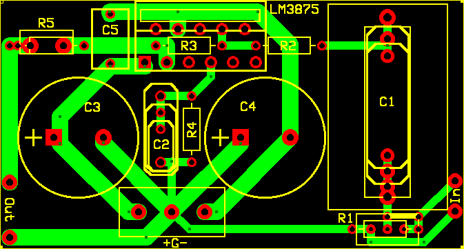

This is my first post on this forum, so I firstly would like to say thanks to out landlords and to the people willing to share their wisdom here.
I designed a pcb for the original Thorsten Loesch's Gainclone circuit with ExpressPCB and I'd like to share it with everybody interested. I'm not an electronics engineer so I don't know how bad my design is :). Any advice or suggestion is very very welcome.
The inspiration for my pcb comes from another post on diyaudio showing a mono power amplifier without volume control, built around a cheap Hammond (?) aluminium enclosure. The pcb doesn't need to be bolted to the enclosure, since the LM 3875, the input and the output connectors should keep it in place.
A few details:
- the .1" traces should be thick enough to allow 4 Amps;
- the placement of the input and output pads is provisional and it should be updated, depending on the choice of connectors available;
- I privileged the placement of the feedback resistor (R3) and of the 1uF decoupling cap (C5) over the placement of the reservoir capacitors (C3/C4), that are a bit far from the chip;
- I assume the resistors are BC 0.6W (like the ones sold by Digikey) except for R5, that should be a 3W (bigger) resistor; Eventually, on the pcb there's place to lay 4-5 BC resistors
in parallel;
- R3 is soldered between the "legs" of the LM3875;
- the 1uF capacitor (C5) could not fit the little space available on the pcb; in this case a smaller (.1uF ?) cap should be used;
- the reservoir caps are Panasonic FA/FC 2200uF, 50V;
- the "-G+" yellow box is a Weidmuller 3 poles connector (code 176050);
- R1 is a Bourns cermet trimmer;
- There is a naive attempt to star ground the circuit :).
The Panasonic caps, the Weidmuller comnnector and the Bourns trimmer are sold by Digikey in Usa and by RS-components in Europe.
Thanks very much for your comments. I'll post the ExpressPCB and postscript files as soon as I'll have a decent version of this pcb. If anyone is interested in the current version of these files, please let me know.
Ciao,
Massimo

Li,
Thanks for your kind words. Unfortunately, since the pcb is fully untested, in spite of the (at least apparently) clean design I cannot say anything about it sound... :scratch:
Nuuk,
may I ask what do you think about the pcb?
Thanks very much for your help,
Massimo

Since I'm a new user, my messages get quarantined and appear only after a few hours. Please note I'm not complaining about the diyaudio policy... :goodbad: Moreover, my attachment got lost in the hyperspace. It was certainly my fault. Hope you may find this one.
PerAnders
Maybe I would have a 4-pole connector instead and let the speaker ground be even shorter.
Stupid question: would you like to use the fourth pole to improve the contact of the two ground lines from the rectifiers or to connect the speaker ground?
Speaker: my initial idea for the pcb was to solder or to bolt some kind of speaker connector (e.g. Neutrik Speakon) more or less directly to the pcb. Using binding posts and accepting some asymmetry on the rear panel, the speaker gound could be made very short.
Ciao and thanks once again,
Massimo
  • gc05.zip
Nuuk,
Hi Massimo,
I haven't had a chance to go over it and check every detail as I have a visitor at present. However, it is very neat and compact, you have kept connections as short as possible and I can't see any reason why it should not work well.
And it's a good idea to leave space for any of the 'extra' components that may be needed later. :nod:

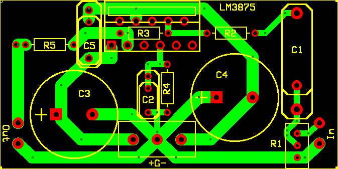

One size fits all?
Hi everybody and thanks for your attention. Following many discussions by email and in another thread about coupling caps (thanks very much, gentlemen!), I updated the Gainclone pcb. The new pcb is a bit taller than the old one (2.8x1.5 instead of 2.8x1.4) and should fit various decent-sounding components, as described below. Hope that Gainclone tweakers might
find this pcb useful.
R1
It can be a Bourns 3296W series trimmer (RS, Digikey), a potentiometer (wired someway to the pcb) or a simple resistor (like R2, see below) if you want to build a power amp. In the latter case you will have to solder a wire bridge between In and C1 (i.e. the big yellow line on the pcb).
R2-R3-R4
Beyschlag/BC MBB0207 .6W resistors (Digikey). Since the resistor pads are .4 (10,16mm) far apart, the pcb should also fit Welwyn RC55 (RS, Farnell) and Vishay-Dale RN55, but not the RN60.
R5
Caddock MP915 0.2R (RS) or any other resistor with lead spacing not greater than 12 mm (i.e. an ordinary resistor with an inductor wound on it). Suggestions are very welcome.
C1
Every capacitor with maximum size 31,5x18mm and
- 15, 20 or 22.5 mm lead spacing with 0.8mm lead diameter, or
- 27.5 mm lead spacing with 1mm lead diameter.
See attached Excel file CAPS_allowed.xls for a list of capacitors.
C2
Many capacitors with 5, 7.5 or 10mm lead spacing.
C3-C4
Panasonic FA and FC from 1000 to 2200uF (RS and Digikey have all, Farnell has some).
C5
Epcos MKT B32560J1105K 1uF 100V (7.5mm lead sp.) polyethylene stacked cap, recommended by Thorsten Loesch. RS product code: 191-3452, Farnell product code: 545-934.
This nicely priced cap (about .6 Euro) should be available from Newark or somewhere else in the Americas.
Power supply connector
Weidmuller 1760500000. RS product code 408-7887; Digikey product code 1760500000-ND.
Input and Output pads
Placement is still provisional and depending on the actual connectors and enclosure.
Disclaimer
This pcb is fully UNtested; please check (at least on a paper print) if your components fit before using the pcb. This implementation could be prone to oscillation, noise or other problems. I'll post further information as soon as I'll implement the amp.
Ciao, :)
Massimo
